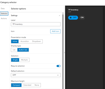

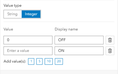

StevenDel_Castillo
Hi
I've found a workaround solution to make it easy for users to turn layers off and on by simply clicking a button. Perhaps this will help with your inquiry. See screenshots below.
This works since there is never a "0" objectID, which becomes my OFF button. ON is basically everything else non-zero.
Steven

StevenDel_Castillo
hi @BrettP
simplest way is to have the layers on in the map that drives the dashboard. if you are using my workaround solution of having distinct on/off buttons for the layers in the dashboard then you just simply have to change the toggle on the Default Selection under Selector.
valenj88
@StevenDel_Castillo Well the latest ESRI update killed these very tidy on/off buttons.  I've been trying to figure out a way to replicate this with the new options but can't figure anything out.  Have you had any luck?
StevenDel_Castillo
hey @valenj88 yeah that wasn't great. Esri should of done a better job of notifying eveyrone of the update (I suspect they are pushing a lot of updates before the UC). THANKFULLY, my colleauge was able to find a solution. The solution is to create a new entry for the ON but leave the Value null.
Then in the Selector settings turn on the Require Selection to On and set the Default Selection to OFF.
