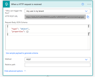

Hello,
I've been struggling with a custom print service occasionally failing/timing out and I want to figure out just how often this is happening, so I thought to try setting up a webhook to email me when the tool runs. I'm working in local government on Power Automate, Enterprise 11.5. I've successfully set up a few PA flows based on Survey123 responses, but I'm still not super comfortable with this tool for basically any other workflow. From what I understand, I should begin this task using the 'When a HTTP request is received' trigger. I've done that, and added a second step to generate the URL.
I then test out that URL in my browser and from the Server site running the GP service and get this message:
{"error":{"code":"TriggerRequestMethodNotValid","message":"The HTTP method for this request is not valid: expected 'POST' and actual 'GET'.","messageTemplate":"TriggerRequestMethodNotValid"}}
Which from previous posts I believe is a fine response?
Then I go over to my server admin and attempt to create the webhook:
But I get the response: 'Error Unable to create or update webhook. URL is not reachable: <POST URL from PA>'
Again, fairly novice at PA, so any help is appreciated!

ZachBodenner
MVP Regular Contributor
Thanks for the detailed response! So I ran the powershell command and I got an error that began: Invoke-RestMethod : {"error":{"code":"DirectApiAuthorizationRequired","message":"The OAuth authorization scheme is
required. Please add authentication scheme and try again."}}
So it turns out my issue was not so complicated as all that: I actually just had to change my authorized triggerer from anyone in my org, to just, anyone:
Now I'm not done with the whole thing yet, so I might have another question, but for now I'll mark your response as a solution!

OlaIHamed
Glad you got it working, Zach!
That makes sense. The "Anyone in my organization" trigger requires Microsoft Entra ID authentication, which ArcGIS Server doesn't provide when sending webhook requests. Changing it to "Anyone" is the right approach.
One thing to keep in mind: with the trigger set to "Anyone", the endpoint is publicly accessible. The URL itself is long and random, so it's unlikely someone would guess it, but if you want an extra layer of security,
you could configure a Signature Key/Secret when creating the webhook and validating it in your Power Automate flow for an extra layer of security.
