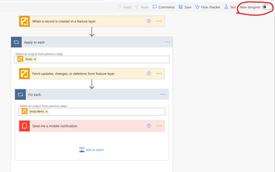

Okay so I am trying hard to understand why some of my flows are working and others are not. I have a few flows that I am trying to post a message in teams for PM's to know when data is being collected.
this first image of my workflow is posting correctly
this second flow is not working - like will not collect or get a trigger
and finally this next one give an error saying The execution of template action 'Apply_to_each_2' failed: the result of the evaluation of 'foreach' expression '@outputs('Fetch_updates,_changes,_or_deletions_from_feature_layer')?['body/items']' is of type 'Null'. The result must be a valid array.
any thoughts?

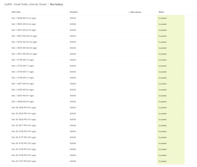

I don't want to get too excited, but I noticed that starting November 30th, around 11am - 12 pm ALL my flows started running successfully.
I believe that there has been update to AGO, is the last day or so. Does that have anything to do with this change?

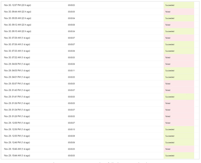

And here is a screen shot from before Nov 30 (11am-12pm).

We have pushed an update (around that time yesterday) to the ArcGIS Connector in Power Automate to fix one of the two issues that have been reported in multiple areas (and thought it would be good to post in this thread). I will be making a larger post about this shortly for the whole board to see. 😀
  • When the Fetch updates action is called, it returns an empty response
This issue has been tested extensively and appears to be resolved. This issue has been deployed to production.
NOTE: The issue with empty arrays is still under investigation and has not been resolved in this push.
Please let me know if you have any questions or if you see any other additional unwanted behavior.
NataliyaLys
@AnthonyLatini  Thank you for the updates. I just checked all my flows from the weekend, and since the update on the Nov 30th, everything has been running as expected!!! Thank you again for fixing!

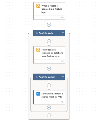

Hello @AnthonyLatini, is this workflow still working properly or are there any reported issues? I am using the ArcGIS connector for the first time and setting it up similarly to this post, except using Outlook email instead of Teams. For example, I have the flow set up as when record is updated -> apply to each fetch updates -> another apply to each send email.
It is not working where I test the flow and make a change to the layer, nothing triggers and the flow does not even trigger the first step (where record is updated).

The execution of template action 'Apply_to_each_2' failed: the result of the evaluation of 'foreach' expression '@{triggerBody()}@{body('Fetch_updates,_changes,_or_deletions_from_feature_layer')?['items']}' is of type 'String'. The result must be a valid array.
LeviCecil
I'm having the exact same issue with this flow using Gmail. It's not getting past the first "apply to each" before I get the array vs string error.
