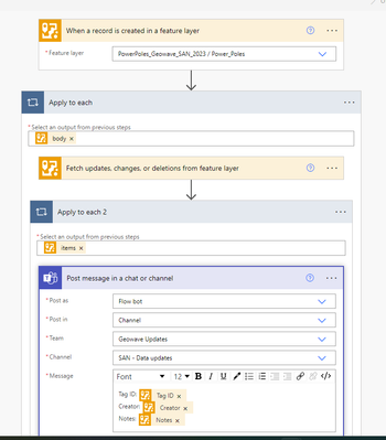

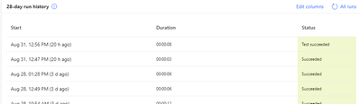

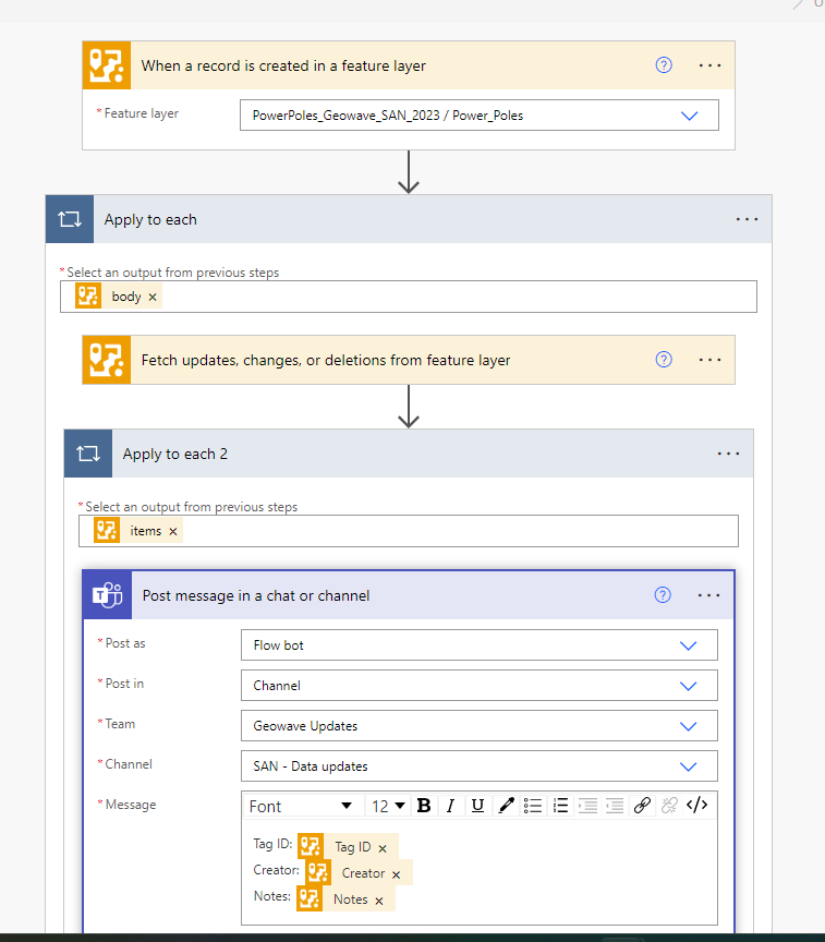

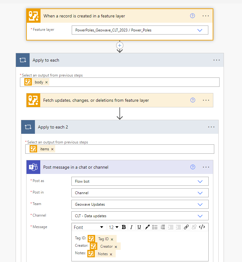

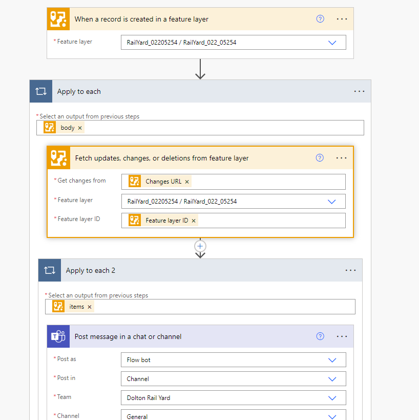

Okay so I am trying hard to understand why some of my flows are working and others are not. I have a few flows that I am trying to post a message in teams for PM's to know when data is being collected.
this first image of my workflow is posting correctly
this second flow is not working - like will not collect or get a trigger
and finally this next one give an error saying The execution of template action 'Apply_to_each_2' failed: the result of the evaluation of 'foreach' expression '@outputs('Fetch_updates,_changes,_or_deletions_from_feature_layer')?['body/items']' is of type 'Null'. The result must be a valid array.
any thoughts?

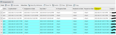

I'm also struggling to understand why some of my flows work and then stop working out of no where. My flow should trigger anytime a change is made to a feature service but I've noticed that it doesn't always run when an update is made. In my example below, someone added a bunch of new features to the assignments feature service on Aug. 30th but the flow didn't trigger at all that day.

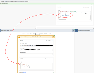

I am catching up on this and wanted to provide feedback. At the moment, there is a known issue with the Fetch updates, changes, or deletions action. In the issue, the changes that are captured can come back as [ ]. Meaning, there weren't any changes captured even though there might have been a new record created, updated, deleted.
Both @Pavel148 and I have been attempting to track this issue down and are working with the ArcGIS Online team to determine the best way to reliably reproduce the issue and the determine a fix. This issue does not appear to be stemming from Power Automate or the ArcGIS Connector inside of Power Automate, but rather from the layers themselves.
In my experience, when testing this issue, I was able to reliably reproduce it on one feature layer, but then not reproduce it in another.
As a note, everyone appears to have their flows set up properly and you are working through it in the correct manner.
Please sit tight with us as we work to resolve this issue. Thank you all for your patience!
