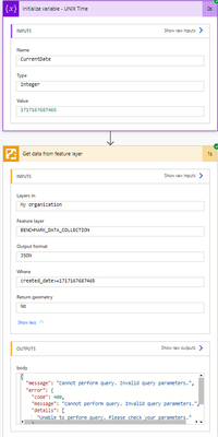

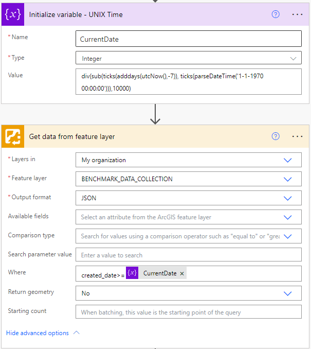

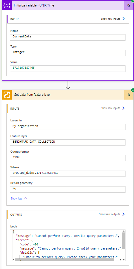

I am trying to use the Get data from feature layer to bring back any records that have been created in the last seven days.  Every time I try to query on a date file I receive an error "Cannot perform query.  Invalid query parameters".  If i query the Feature Layer on a field that is not date, i have not issues.  It is only when I attempt to query on the date fields.  I have tried using the Available Fields/Comparison Type/Search Parameter Value and the Where fields to do this.  Does anyone have any ideas?
Below are some screen shots of my flow steps with the formula's shown.

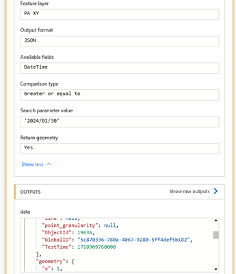

Hello,
Thanks for your feedback. I was able to reproduce and identify the issue.
You need to provide the date as a string, such as '2024/01/23'. See the example below.
Please, for now, add single quotation marks (') around the date: for example: '2024/02/14'.

Hi,
Could you please check a couple of things:
1. If you use the drop-down and select the field "Created_date" does it work?
2. What is the datatype of the field created_date?
From your query, it seems that you are likely passing a Unix Epoch (integer) to a date-type field.
MJune
I attempted to use the drop-down and select the field, that did not work either.  The created_date is a "Date" field.  I was attempting to use a regular date format without success.  When i pull back all records, the created_date field is in the Unix Epoch format
