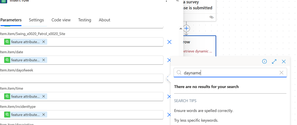

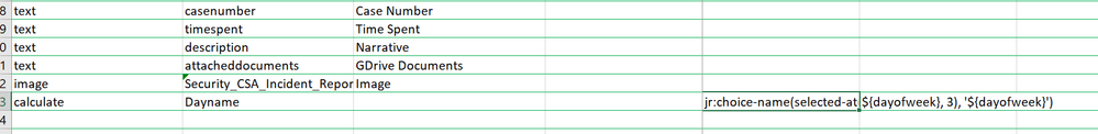

OK, thanks. I added a calculate field called "Dayname." Now I need to figure out how to bring in this field to the Power Automate flow. It's not listed in the dynamic variables.
JenniferAcunto
You are using a calculate question type without a label value, so that value is not being retained or stored in your data. I would make it a text field with a hidden appearance.

OK. I set the field type to text, hidden with a label "Day Name". The bind::esri:field type is set to null. I'm able to successfully republish but it's still not showing up as a dynamic variable in Power Automate s123_3.PNG

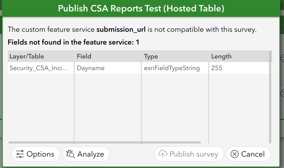

OK. If I set it off null, it tells me that there is no field called Day Name in the feature service and won't publish.
JenniferAcunto
You are using your survey with an existing feature service, so you need to add the Dayname field to the layer first and then republish your survey.

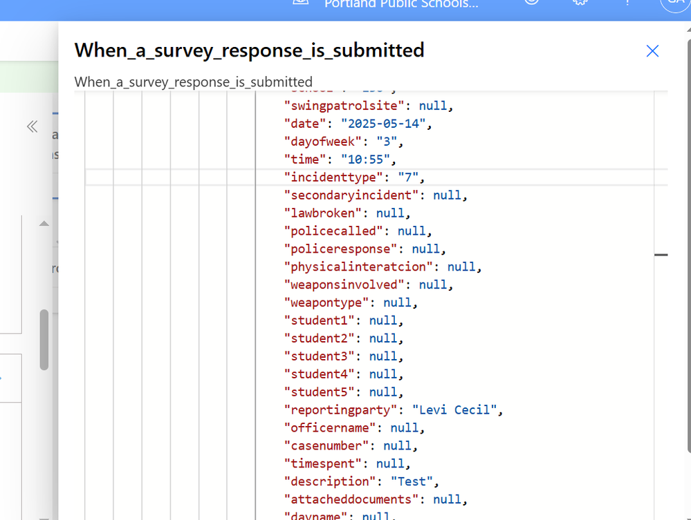

I added the field dayname to the feature service and added this variable in Power automate. It's coming in blank in Google Sheets. My calculation is jr:choice-name(selected-at(${dayofweek}, 3), '${dayofweek}')
The raw outputs of the S123 connector all have the domain codes. In this case dayofweek is 3, but dayname is null
