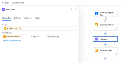

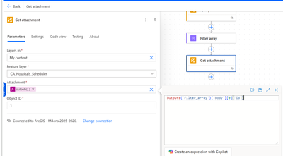

@Jean-PhilippeLabrecque Get attachment action has not changed in a while, and always needed an attachmentID which is different than the objectID.
Is it possible that you luckily had the same attachment id as the object id? Maybe new attachment was added to the feature and the old attachment was deleted instead of being replaced causing the failure.
If you want to dynamically get the attachment ID using the attachment name, I recommend you to use Query attachment action and then use get attachment or get attachment from URL using the attachment ID/url returned from it. If your feature has multiple attachment then you may need to filter them out using Filter array then dynamically get the attachment using get attachment action.
*Note that I removed the get attachment out of the For Each loop and added a formula to get the 1st item's 'id' in the filter array
Thanks,
Akshay Harshe
