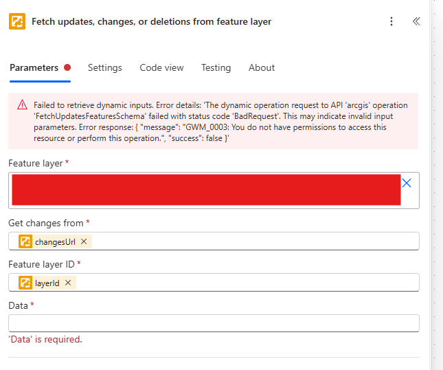

I had a flow that has been working up until 6/2 and I just went and checked and now it is throwing an error because the Data parameter is blank in the Fetch updates, changes, or deletions from feature layer action.
I can't find any documentation on this change or what the Data parameter is supposed to be. Any suggestions?
AkshayHarshe
@NolanNiedermeyer, can you try deleting and readding the action? In the recent update we added a dropdown to filter your layers in My Content /Organization etc. The change should not break existing flows so not sure why this error is thrown. Also check if the layer is unshared or overwritten.
When an action goes in error state, Power Automate sometimes shows that Data input box.
Let me know if that works.
