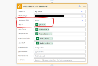

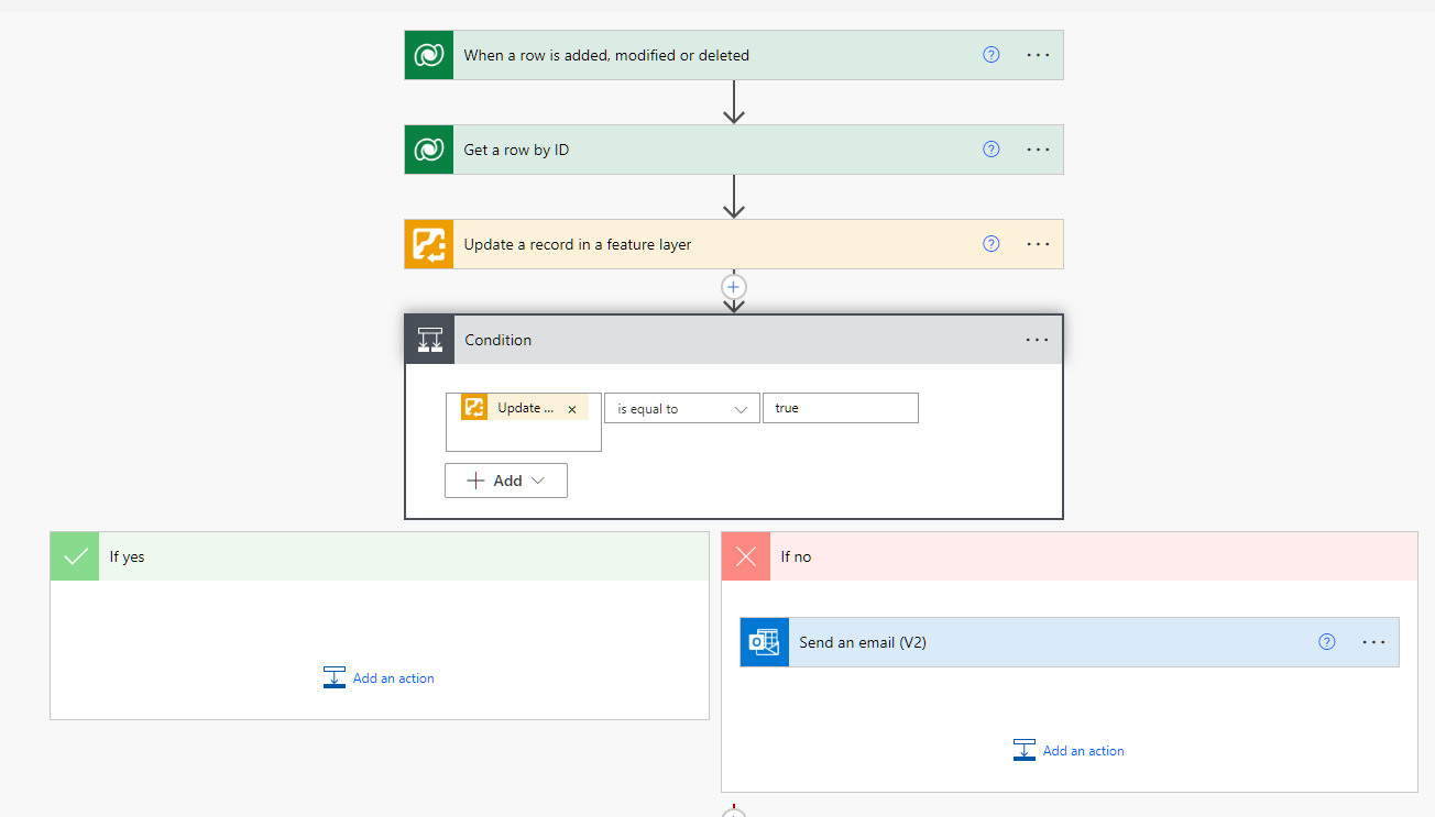

this is what my flow looks like right now:
So, I am seeking an advice on how I could use the flow to update these 3 polygons with the same record from Dataverse.

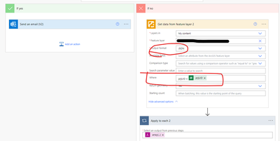

If I have multiple GIS records with the Dataverse unique ID, the process will fail. So I added a condition to bypass that.

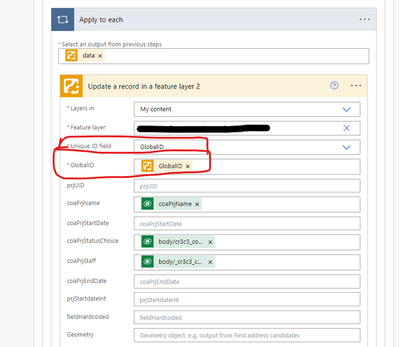

if it fails, I create a JSON recordset using the Get Data from FeatureLayer
I then loop through each records and update the feature layer based on the GlobalID returned by my JSON object and update each fields from the Dataverse recorset.
