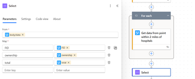

If you would like to achieve this for now you can simply use a select action in front of the `Get data from feature layer`.

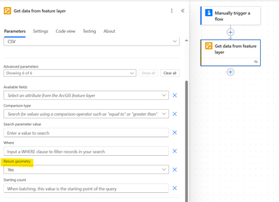

@CarterHughes Return geometry is currently part of the get data action, click `Show all` Under Advanced parameters.
