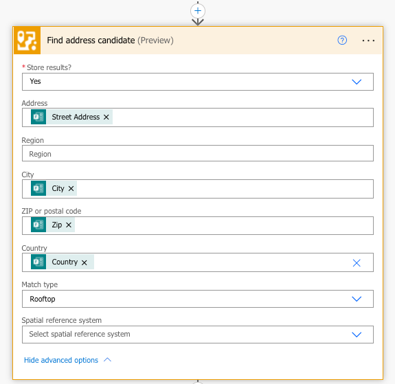

The spatial-enablement occurs when we geocode the address information submitted in the form. For this scenario, we are using and ArcGIS Online identity to geocode using the 'Find address candidate' action from the  ArcGIS Connector. This logic is also possible is you do not have an ArcGIS Online Organization, you can leverage the same action but leverage the ArcGIS PaaS connector and pay as you use the capabilities.

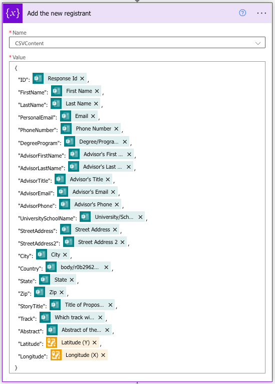

To access the information in Power BI, we are connecting to a CSV file as the data source. We need a way to keep the CSV current, to do that we need to access the file and parse it so we can add additional information to it.  The Flow maps the inputs from the form to the columns in the CSV. For the location aspect, I map the Latitude & Longitude response from the geocode to the Latitude and Longitude columns.
