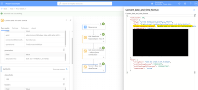

How do you know you are looking at 2026.2?
  • Create a new flow with a manual trigger.
  • Add Convert date and time format action.
  • Use formula to add `utcNow()`
  • Run the flow
  • In the run click on the Convert date and time format action then select Show raw outputs
  • In the headers section you should see the arcgis_connector_version
    Alternatively, you click create new connection it should give you a dropdown to choose between User login and API Key.

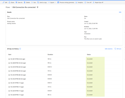

Case 1
Old connection Pre June 3rd that I reconnected after the roll-back (after June 9). The flow is working as expected but when I edit the flow I see this it is in the error state
FIX
  1. Open the flow.
  2. Open the action with error
  3. Click change connection
  4. Select a different connection
  5. Re-select the original connection.
  6. Save the flow

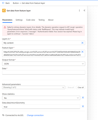

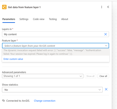

If you see your connection is still connected but when using it in a flow throws following error.
OR
FIX
  1. Make sure you are not logged in to ArcGIS Online in another tab (so the reconnecting won't pick up the log-in details from local storage without asking you to log in), if in doubt use a incognito window to log into Power Automate.
  2. Open Connections dialog
  3. To find the connection associated with a flow click on 3 dots in front of the connection and click View Properties
  4. Check the flow(s) using that connection and confirm it includes the flow you are fixing
  5. Click Reconnect should open sign in dialog
  6. If you don't see Reconnect active choose Switch account.

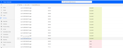

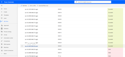

Find out when they started working

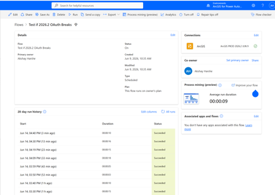

  1. Open the flow
  2. Under run history  click All Runs
  3. Filter only failed runs using the dropdown on the top right corner.
  4. See all the runs that failed.
See example below
AkshayHarshe_6-1781535744074.pngAkshayHarshe_6-1781535744074.pngAkshayHarshe_7-1781535761872.pngAkshayHarshe_7-1781535761872.png

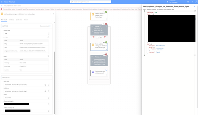

We are getting this error now. We have several public safety flows that are broken and need to be running. Can ESRI dedicate additional resources to this?
Fetching data from www.arcgis.com failed. This is usually caused by an invalid authentication token that has expired. Please reauthenticate to continue. Error message: undefined 498: Invalid token. Upgrade

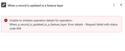

Too add on top of all these issues, is anyone else not seeing their Webhooks in the"Settings" page for a survey on the Survey123 website? The flow is active and has active connections to this survey but the Webhooks section seems to have disappeared all of a sudden and I can't update the webhook settings?
JamesWheaton4
Frequent Explorer
JacobMyers said it changed his webhook settings here: https://community.esri.com/t5/arcgis-connectors-for-power-automate-questions/power-automate-connecti... not sure if its related

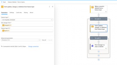

As of this morning this fix is no longer working. After I update the connection by adding a new one, publish, and go back to My Flows page I am hit with the error below:
There's a problem that needs to be fixed to trigger this flow. To see more details, open the Flow Checker.
I am using the ArcGIS - When a survey is submitted trigger.  I have the government suite of Office 365 and we use OKTA for IAM.  This flow is using an ArcGIS Online account using the same email/login as my Office 365 account.
Essentially I am in some loop where I update the trigger and its fine but after i close the Edit screen for that flow the trigger is broken again. I can go back in and add a new one. But its broken as soon as I go back to my flows. I have 3 duplicated connections now because of this and flows actively failing.
ISP_graynic
Created a new copy of the flow and re-connected the ArcGIS Connector which seems to bring a new webhook in and the Settings page is showing webhooks now. Not sure what that was about but with all the changes going on wouldn't be surprised if it was related. Thanks @JamesWheaton4!

@JamesWheaton4 @ISP_graynic I might be wrong but this seems to be tied to the 404 error, where it completely breaks your webhook. It hasn’t happened to any of my flows yet, but it has happened to my colleague. When you fully create a new connection and redirect your triggers to that new connection, you’ll need to reconfigure your webhook settings back to their original state (for example, enabling triggers to fire on edits). This also forces users to download a new Survey update in Survey123.

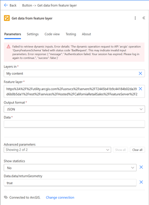

After changing all of my connections the day this was posted, I am finding myself having to change the connection to any flow that I need to edit.
Any flow that I can leave as is, still seems to be sending emails up until 13 minutes ago. But I have just coincidentally had three requests come in for updated logic in some of our flows, and I cannot do anything until I cchangethe connection. Here is the error I am receiving on the brand new connection from earlier this last week.
Failed to retrieve dynamic outputs. As a result, this operation's outputs might not be visible in subsequent actions. Error details: The dynamic operation request to API 'arcgis' operation 'WebhookPayloadSchema' failed with status code 'Unauthorized'. This may indicate invalid input parameters. Error response: { "error": { ------- "message": "The response is not in a JSON format.", "innerError": "Cannot read server response." } }

Case 1
FIX
  1. Open the flow.
  6. Save the flow
OR
FIX
  1. Open the flow
See example below
