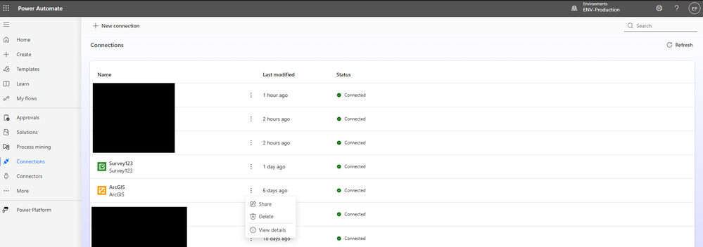

  1. Make sure you are not logged in to ArcGIS Online in another tab (so the reconnecting won't pick up the log-in details from local storage without asking you to log in), if in doubt use a incognito window to log into Power Automate.
  2. Open Connections dialog
  3. To find the connection associated with a flow click on 3 dots in front of the connection and click View Properties
  4. Check the flow(s) using that connection and confirm it includes the flow you are fixing
  5. Click Reconnect should open sign in dialog
  6. If you don't see Reconnect active choose Switch account.

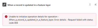

Still having issues with some flows even after creating a new connection and updating them.
On this, with the connecter to watch for edits to a layer, I am getting this new error when I try to save a flow with the new connection (and have verified it is able to see the service):
The above was caused from downstream actions that also needed their connections refreshed to ArcGIS as well, that was in the initial post, sorry about that.

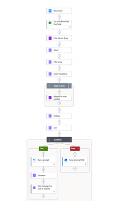

KylaCupp_SBY
Hey,
If you have your flow in a Solution you can create a error handling flow. None of our flows are emergency status so we just have it run once a day and if nothing is broken we get a trivia fact in teams and if something failed it lists the flow and the error in the email. I'm sure there is a better way to set this up where it's triggered when a flow fails but this has been really helpful for us.  It leverages the Dataverse flow run table. Happy to share more info you have questions.
The downside of  having flows in solutions though is that it's even harder to fix when an ESRI update accidentally breaks all of the connections 😅.

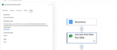

Erwinvan_Veen1
Sometimes the old connection does show the 'Switch account' option and sometimes it does not. I did not really look for a pattern to find the reason is sometimes doesn't show. All my flows should be using the new connection, although the old connection still shows all the flows it used to be in. It doesn't seem to be updated in which flows it is used. Quite confusing. I am afraid to delelte the connection enterily, because it may perhaps cause some unexpected behaviour.
I am unsure where I can find the connector version. In the action 'Get data from feature layer' for example I did not see this particilar part. Not in code view at least of either the edit-mode of the flow or in a log from a previous run. Nor did I find the version in the Connections in PowerAutomate. If you could point me in the right direction, that would be great.

Theisen
I am unable to even create new flows now using arcgis connectors. I get the attached error and no options to switch accounts or re-authenticate. I have deleted triggers and actions and tried to replace but I get the same message. Anyone else seeing this issue?
AkshayHarshe
Update
It appears that Microsoft tried reverting the recent release back to 2026.1 to minimize impact. It is frustrating to say the least, that this is not something we asked for to happen as many of you have already created new connections with (new) multi-authentication and updated your flows. Last night none of my flows were working. As of this morning they have provided a fix that I am testing. I will update everyone after I have additional information. Thank you for your patience.
Theisen
Sounds good. All of my flows are still broken so we will be waiting for your response.
erica_poisson
I am still seeing no change in my ability to refresh my existing connection. I am a GCC Microsoft customer, if that is relevant at all.
Screen grab of Power Automate "Connections" with the ArcGIS Connector's options expanded. No "Refresh" option is available.Screen grab of Power Automate "Connections" with the ArcGIS Connector's options expanded. No "Refresh" option is available.
