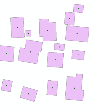

I have polygon data and point data (generated from polygon data), then I do some process with point and I want  to put attribute data from point back to polygon by using spatial join tool.
After using spatial join tool, I got the result that all of them have SHAPE_Area = 0.
