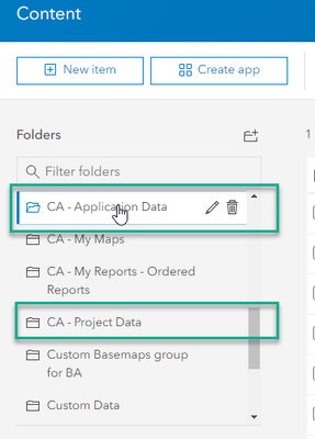

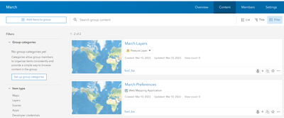

The project layer and the project preferences file are the only items associated with a project (shared with the group by default). You can easily identify which of these items belong to what project by their names. For example below, I have a group/project named March and the contents also reference that name as March Layers and March Preferences
You can find these items under CA - Project Data folder and CA - Application Data and delete them if not needed.

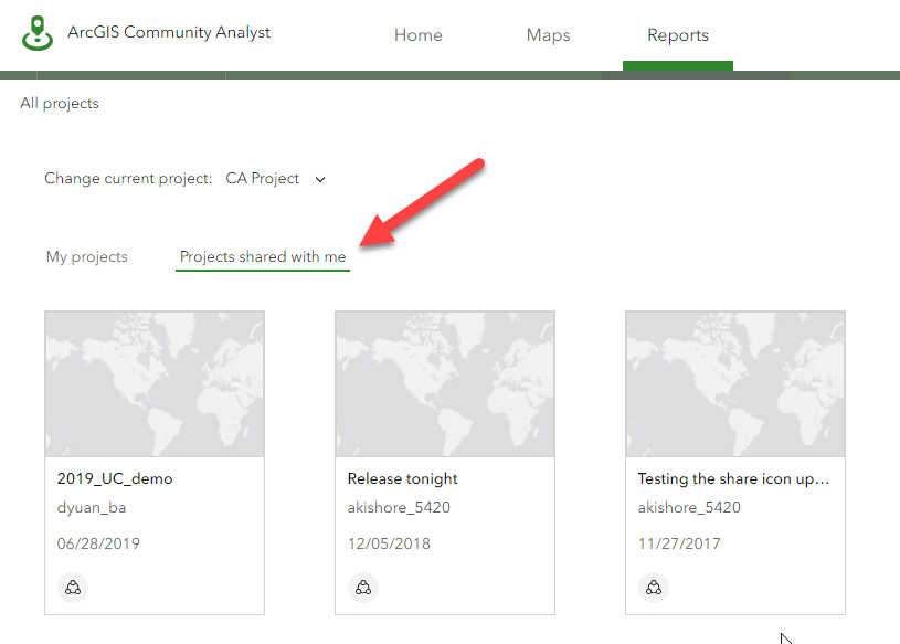

@AmyRoust Sorry if I was not clear but that is not correct. If you delete the group (Community Analyst Project), it will disappear from Community Analyst and you will be required to create a new project to continue using the Community Analyst. Or, if you don't have your own project, you can continue to work by using a project that is shared with you here:
Without a project, you will not be able to use the app and will get error messages.
