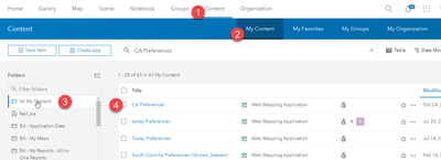

1. Log in to ArcGIS.com > click Content > My Content
2. Select All My Content folder from the left > type CA Preferences in the search bar
3. Select any files named CA Preferences and delete them.
4. Refresh your Community Analyst app/browser and you should be able to sign in.

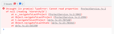

2. Try to log in to community analyst using Google Chrome and click F12 on your keyboard to open the DevTools. Then send me a screen shot of the error shown under the Console tab. Something like this:

MeganWheat
Hi @FasilTiru
I am the ArcGIS Administrator, there really hasnt been much use in this app. I wanted to see what was going on.
Haven't been able to log in all day.  It just gets stuck on the community analyst loading screen. Business Analyst web app works perfectly fine. So I am just not sure what is going on.

Thanks @MeganWheat
This is exactly the error I suspected causing the issue in Community Analyst. In most cases, this happens when a Community Analyst project (a group in ArcGIS Online) is accidentally deleted. This is a bug we recently found and fixed for the November release.
In the meantime, please use this workaround to reset your Community Analyst Preferences.

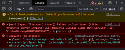

PatriciaCleary
Hi @FasilTiru
here is the screenshot:
Patricia
FasilTiru
@PatriciaCleary Thanks. This appears to be a permission issue with the Ordnance Survey Ireland (OSi) MapGenie Digital Gobe (WM) Service basemap that is no longer available/accessible.

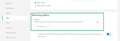

It looks like you might have added this layer in CA and the app is hanging now as it's unable to load the layer. So my first recommendation is to check your organization's basemap galley settings in ArcGIS online and make sure Esri Default option is selected. This is just in case you have a custom basemap galley group with the custom layer above that is no longer accessible.

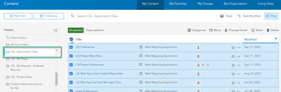

Once you confirm that you have access to the Esri Default basemaps, you can try logging in to CA again. If the app still hangs, try deleting all the preference files listed under CA - Application Data

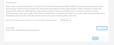

Thanks for your help, that basemap layer is a premium layer and in our organisation I had to put the URL of Community Analyst (https://communityanalyst.arcgis.com/)  into the Limit Usage in the settings of the basemap content item:
This now works - thanks.
