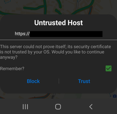

Some of our Rangers are getting an untrusted host error message (see attached). And if you select trust it just throws up the error message again.  You can flick the app out and on most occasions it opens again and works fine.
Running Android 10 with latest updates on a Samsung S20+ and latest Collector for ArcGIS 20.2.1 Build 2956.
Any ideas what is going on?
