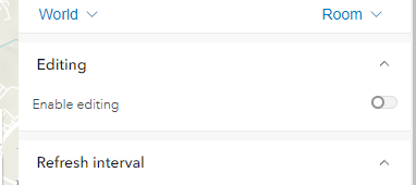

TimWillson
Stan,
I don't know if this is what you are looking for. The best I've been able to do is to disable editing of the feature itself in MapViewer. But have Add/Update checked in the Settings of the Feature Layer. This allowed me to Add to the related table but still maintain the Feature Layer. Obviously, it still doesn't allow to Add new features to the hosted layer, but for my purposes, I don't need them to.

JiaJia
Hello, I have similar issue. Turning off Editing will stop both geometry and attribute editing in the hosted Feature layer, however, we need the field worker to edit the attribute of the feature layer. Our scenario is: when using the field map, the field worker can only add the attributes of the hosted feature layer and add the new record to the related table, he/she can't create/update any geometry in the field map. I wonder if ESRI has any solution on this?
