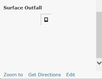

Hi, I'd like to add an image saved on my PC to the pop-up for one of my feature layers.
I've entered the path to where the image is saved in the URL field, but I get the following displayed in my pop-up:
Am I going the right way about this? Perhaps the picture is too large?

Collector can't access the data save on your personal computer via URL.  Try enabling attachment for the layer and attaching images to the feature. FYI, hyperlinks don't work on iOS at the moment (*Hyperlinks in Collector (iOS) )
