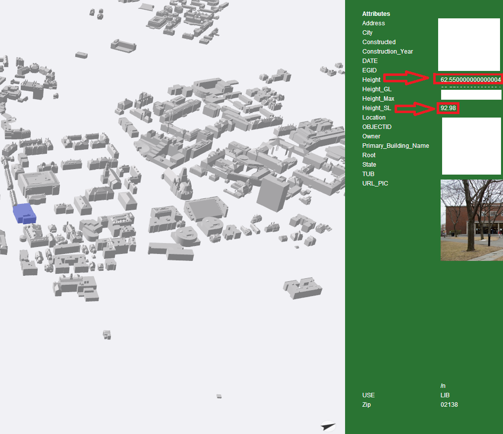

HI,
I am having a problems with my attributes, sometimes the numbers look like that " 23.34"  and sometimes like that "23.3400000000000000"
How can I set it only to 2 decimal places so all my attributes will look like that " 00.00"?
The attributes are the same in ArcMap, yet in CityEngine they are not
In the attribute "Height" one building is 23.43 and the other 23.9800000000000

And under reports it seems the numbers display less decimals. See image. Does that help any?

Yes, it is a shapefile (Gdb) and it looks fine in CE, but when I export it to WebScene it shows as something like this 23.43000000 instead of 23.43
WebScene displays actually in my case 13 decimal places, we set the number values to 2 decimal places, but it is still wrong in the WebScene
So in one attribute "Height" some numbers are correct (0.00) and other are like that (0.000000000000)
How can I set all the numbers to be only 2 decimals in Web Scene?(we did that in ArcMap, and CE)
