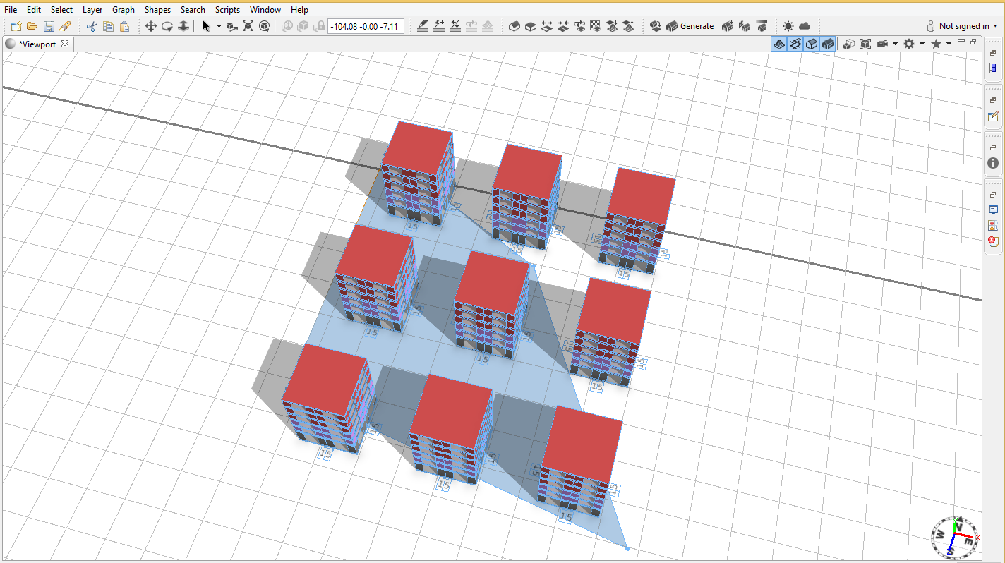

Hello everyone,
Wonder if there is a way to 'clip' the grid that is created by Marker_Based_Building.cga (rule by Matthias Buehler) to just the shape that is being applied to ? Appreciate all the responses.
Thanks.

You could try to use occlusion queries.  Create a shape (needs to be closed shape with volume) that has the boundaries of your initial shape.  Then, before creating each building, test for occlusion.
Occlusion Query Functions
KushanDave
Thanks Cheryl. That seemed to do the trick.
