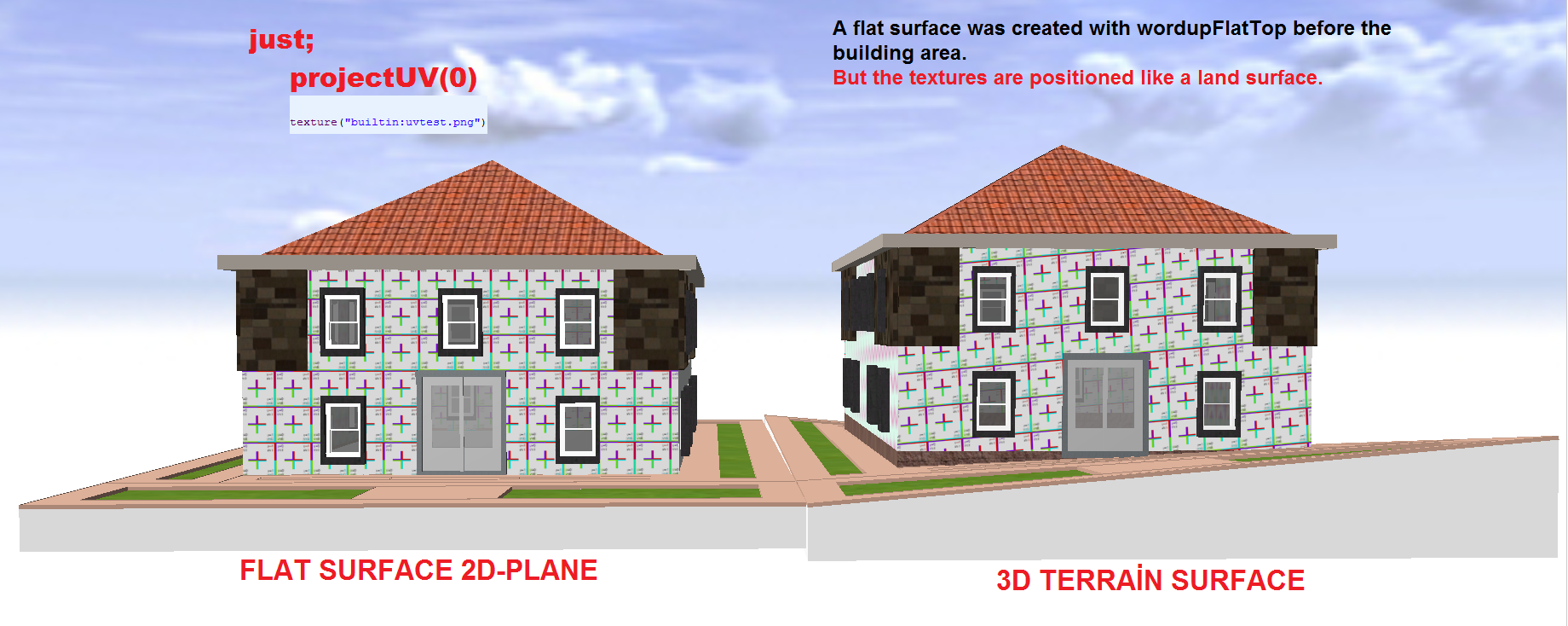

   I didn't use setupProjection because the surface was divided into too many parts when I was doing Texturing on the walls. It was enough to use projectUV(0) because I use seamless textures.But when plots were formed on 3d surfaces, I got help from the Align shapes to terrain process. In this way, my parcels fit perfectly on the land surface. But I need to use the wordupFlatTop command in order for the building to be flat.
   The problem started here. The projectUV(0) operation is probably referencing the surface. Even if the building is flat, the textures where the reference is crooked are not compatible with the building.

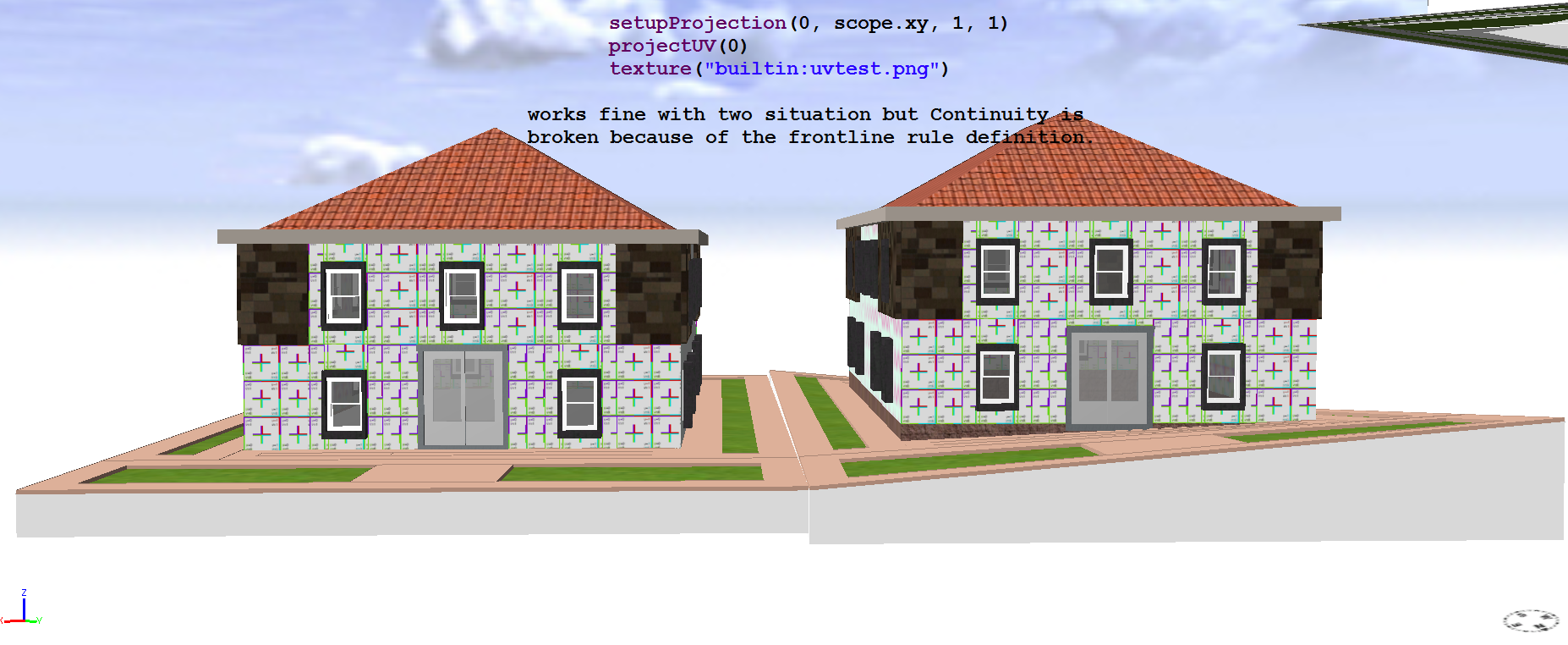

   When I use it as setupProjection(0, scope.xy, 1, 1), it does not give a seamless image because it processes each wall from scratch. But at least it is compatible with the building, not angularly incompatible.

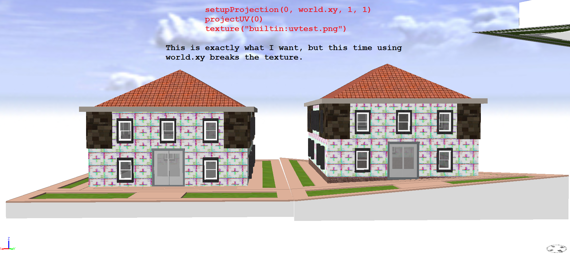

   When I use it as setupProjection(0, world.xy, 1, 1) it actually gives exactly the result I want, but a coating problem arises that I don't know why. A flickering image emerges as if the textures are intertwined hundreds of times.

   Maybe there are other solutions, let it stay open for 1-2 days, then I will close it because it is solved. Btw , I couldn't figure out why setupProjection(0, world.xy, 1, 1) doesn't work properly for me. If anyone knows, it would be nice to share. Textures appear distorted or faded. It's like it's overlapping.

Align the scope to world.y
Your solution of doing setupProjection on the facade before it is split is the way to do it.  If you align the scope to the world y axis using alignScopeToAxes(y) before setupProjection, then the texture should not be slanted regardless of whether the building is on a hill or not.  In your example screenshot above, the slanted texture on the building on a hill is because the scope's x axis aligns to the facade's edge which follows the uphill terrain.  Aligning the scope to the world y axis straightens out the scope vertically.
alignScopeToAxes(y)
What happens with world.xy
The reason why you might see distorted textures with setupProjection(0, world.xy, 1, 1) is because this projects the UVs onto the world.xy plane, and your building's facade might not align exactly with world.xy.  This means the texture will look undistorted when the surface that you are texturing aligns perfectly with the world.xy plane.  The more you rotate the building (around the y axis), the more the texture will look stretched, until you reach a rotation of 90 degrees where the facade aligns with the xz plane and the texture is maximally stretched.  Since buildings usually don't align exactly to world.xy, I would not recommend setting up the projection according to world.xy.
