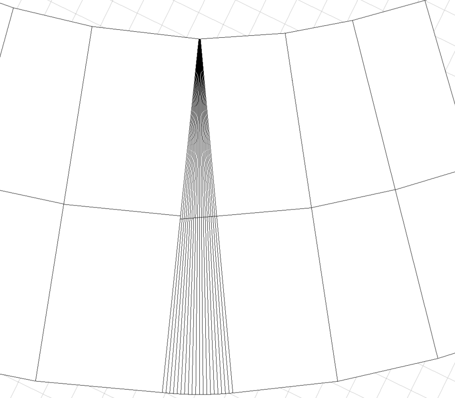

I am using a Street Network to create 3D models which are not streets. The vertices along the imported lines have different elevations.
Part of the process involves to apply a 'split(z)' on the shapes generated from the Street Network. Unfortunetly, the split seems to offset the models in some parts.
I have identified some problems at the 'Joint':
zoomed in:
The rule looks like this (I do not use a @StartRule as I let CE find out which rule to start with, Street, Joint, Crossing, etc):
Joint -->
    split(z){'0.5:C | '0.5:C}
C -->
    extrude(world.y,20)
Does anyone know how to avoid the split to offset from the line direction ?
Thank you.
TT

If I understand correctly, you would like to split the shape as if you were making street lanes.  For this, you could split in the v direction.  Streets have u coordinates that follow the street and v coordinates that cross the street perpendicularly.  (This is uv set 0.)
split(v, uvSpace, 0) { '0.5 : C
                     | '0.5 : C }
Here's the documentation on the uv coordinates on street shapes:
Street and Intersection Shape UVs
Here's the documentation on uv splits (uv split example on bottom of page):
split Operation
