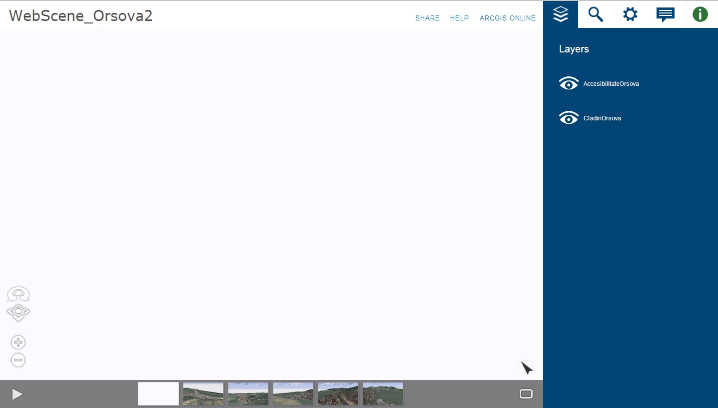

Hello,
I have a problem with the scene exported as .3ws to CE Webviewer. After I upload the .3ws file the scene is not visible, but the bookmarks and the layers are.
I attached a print to understand better the problem.
Does anyone knows why?
Thanks !!

In the scene's bookmarks, the first thumbnail seems empty, while the others don't. What happens when you click the other bookmarks?

Hi,
Can you evaluate the validity of the first bookmark in CityEngine too?

The problem was the first bookmark. It was set by mistake in another area so the whole scene was going wrong.

Hello,
Well, nothing happens, the only think I can do is to "move the camera" clicking my right mouse button...
