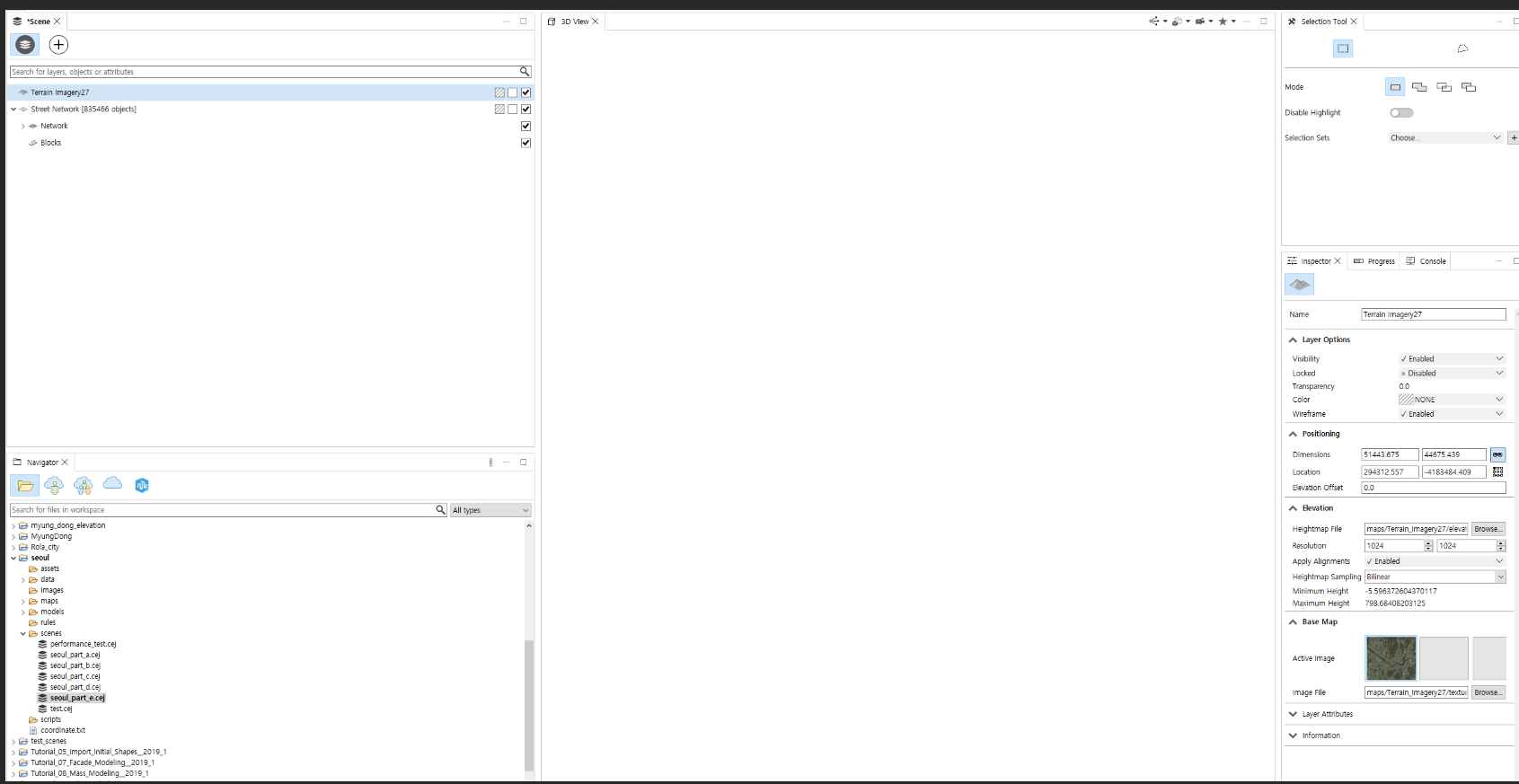

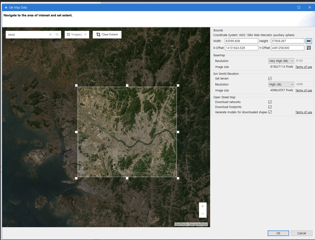

I'm having trouble using "get map data"
when I'm importing somewhat large scale area,
It always ended up not importing footprints and 3d viewport doesn't show anything
(importing Seoul area)
leaving all the options as default
nothing in viewport, no footprints
Is there anything I can try?

Hi @GunSikKim,
Is this only happening in the seoul area or elsewhere too? Do you get any error messages in the log (Window -> Log)
What you can try is to uncheck "Generate Models for downloaded shapes"
Best
Jonas

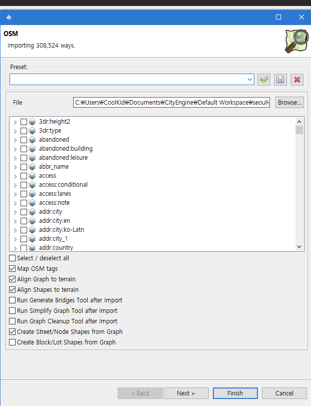

I see bunch of errors in the logs
JonasObertuefer
Esri Contributor
Hi @GunSikKim,
Thanks for the screenshot of the log. I was also able to reproduce it on my machine. It happens only for the street network import. It seems CE has a problem with very large networks. We will look into it.
So what can you do in the meantime?
  • If you don't need streets you can simply uncheck "Download networks" in the dialog
  • If you need streets you need to do seperate downloads for them with a smaller extend (or multiple smaller downloads) The downside of this is that you will end up with multiple seperate street networks which are not connected.
Hope this helps.
Best
Jonas
