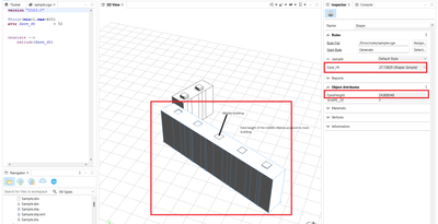

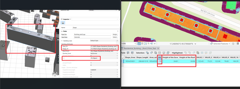

I've encountered an issue while attempting to link attributes of a shapefile into CityEngine variables to automatically retrieve parameter values. While this process works smoothly for some shapes, I've noticed discrepancies in certain shapes where the values of the shapefile are being altered when connected to parameters.
Has anyone else experienced similar issues? I've double-checked the attribute linking process, and everything seems to be set up correctly. However, it's puzzling why only certain attributes are affected.

Looking at your screenshots, it seems like you connected the object attribute "Height of the Eave" with your rule attribute "Eave_Ht" via a layer attribute. Have you checked what the values in the Object Attributes section of the Inspector are? Maybe the difference is showing there as well?

Thank you for your reply. Strange issue is that within city engine object attributes are showing correctly as well. Only when calling the attribute as a parameter gives the incorrect value.  What I observed is that it mostly gives the value of the middle object to the main building. Refer to the attachment.

Thanks for verifying this. With the connection editor, you mapped the Rule Attribute "Eave_Ht" to an Object Attribute named "EaveHeight". This created the following entry in the Layer Attributes of the "Shapes Sample" layer:
attr Eave_Ht = getFloatObjectAttr("EaveHeight")
All Object Attributes of objects in the source layer at the location are getting sampled. In your case the value of the object in the center is returned.
The behavior is expected.

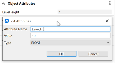

To make a direct connection between a Rule Attribute and an Object Attribute, the names must match. Either add an extra (optionally hidden) attribute to your rule
@Hidden
attr EaveHeight = 50
attr Eave_Ht = EaveHeight
or edit the name of the object attribute
Inspector—ArcGIS CityEngine Resources | Documentation
