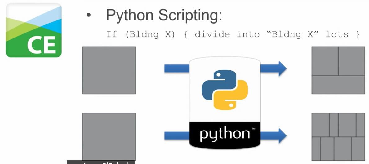

So I want to know if there is another way to split parcels into lots? I have seen a case video about this for Transit Oriented Development simulations (seen here), and it mentioned python scripting (as shown below) but no details about how to complete this...
What's more, I knew the key algorithm of Recursive Subdivision in CityEngine is OBB (Oriented Bounding Box), so it will be greatly appreciated if anyone can give suggestion about how to implement the OBB algorithm in python code!

Instead of using ce.subdivideShapes(), another way to subdivide parcels into lots would be to write a cga rule that uses splits.  The cga rule can be assigned in python (ce.setRuleFile(), ce.setStartRule()), then generated (ce.generateModels()), and converted to shapes (ce.convertModelsToShapes()).  Here is a simple cga rule that creates the first example (top right in your screenshot) with some randomness built in:
Parcel -->
	split(z) { 'rand(0.3,0.7): split(x) { 'rand(0.4,0.6): Lot.
										| ~1: Lot. }
			 | ~1: Lot. }
One random result looks like:
