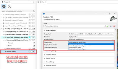

Hi all, I am testing CityEngine as a trial. I am testing the export functions, for which we need FBX.
Exporting to FBX works fine. However, the "Basemap Imagery" of the tutorial scene does not export. I notice it is not a selectable export. How can I export this as an object with the imagery correctly mapped onto it?
JonasObertuefer
Hi @TomBos2,
You can't select basemaps / terrain layer directly in the scene, you need have them selected in the Scene Editor before exporting (use Ctrl + Click)  alternatively you can choose Export all visible terrain layers / All terrain layers under Terrain Layers in the export settings
Hope this helps
Cheers
