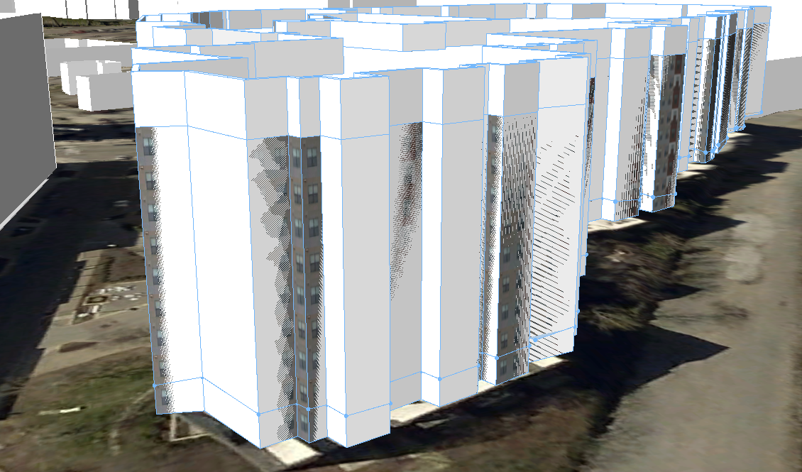

How do I fix the flickering facade?

The rule is a simple
Footprint-->
    cleanupGeometry(all,1)
    alignScopeToAxes(y) s('1,0,'1)
    alignScopeToGeometry(yUp, 0, longest)
    Up
Up-->
    extrude(HEIGHT * 0.3048)
    Reporter
    Roof
Roof-->
    case Style == "color override":
        comp(f){side : color(color_override) | top : RoofGetter}
    else:
        comp(f){side : FacadePainter | top : RoofGetter}
FacadePainter-->
    setupProjection(0, scope.xy, 4, 4, 1)
    Paint
Paint-->
    set(material.colormap,facade)
    projectUV(0)
Tags (1)
KennethLindhardt
Deactivated User
HI,
it seems that you are creating double shape upon each other .
In your Up rule you are creating the same shapes two times, by creating a Reporter and roof. Delete Reporter…
MicahTaylor
Thanks!  I did not realize reporting something in a Rule would cause an empty shape after I already textured that shape.
DavidWasserman
Hey Micah,
If you want to keep reporter, I think you can just add NIL to the end of the rule to terminate the leaf.
Along with creating gaps in a split, it helps with creating reporting rules that just need to get information then disappear.

If you add:
Reporter-->
color(1,0,0)
report("Area",geometry.area())
NIL
The flicker in the images disappears, but the report information remains.
May not help you right now, but thought I would mention it.
