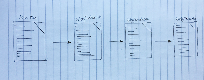

I'm currently working on a way to create a CGA rule file which can generate many different buildings within a short period of time. The goal is to create a rulefile which lets the designer investigate multiple designs without having to redraw his/her project every time. I'm working with the assumption that a design of a building plan consists of three parts, the distributions of the building footprints (bldgFootprints), the envelope (bldgEnvelope) and a facade (bldgFacade).
The goal is to have a main cga rule file, which link to a rule file that draws the bldgFootprints. This file then link to a file which draw the bldgEnvelope, and finally, the bldgEnvelope links to a cga file which draw the bldgFacade.
The overall flow

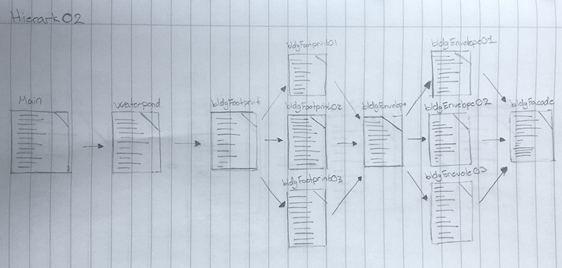

To avoid having to write all of the different "types" of building footprints in one rule file, I would like the bldgFootprint to link to other rule files, and by using a drop-down menu choose between them. Se diagram below.
By using this structure, it would be possible to write a new CGA file for a specific building footprint, and then add that to the overall structure simply by naming the instances within sub-rule file the right names. It would also eliminate the need for writing one very long cga file which can generate all possible building footprints. By using this structure it would be possible to make the "Database" bigger and bigger over time by adding more and more bldgFootprints0X to the project. So the first question, does this seems as a relevant way to do it, it will end up with a very very big amount of rule files and some of them will maybe have the ability to do the exact same thing but on the other hand it allows the designer to create an individual script and add it to the overall structure.
The next question is, I simply can't get it to work, I have managed to link the main file with the bldgFootprint, link that to bldgFootprint0X, link those to bldgEnvelope, but the attributes which is located in bldgEnvelope is not visible in the inspector.
It looks like it is only possibly to have three layers of linked files visible in the inspector, so my "main" can link to "bldgFootprint" which can link to "bldgFootprint0X" and all the attributes show up, but when the  "bldgFootprint0X" links to "bldgEnvelope" the attributes for envelope does not show up..
I'm looking for all the help and thoughts I can get on the subject, does any of you have relevant experiences with this type of project, can you see a more simple path through. Am I on the right track or is it just stupid? If anybody has an interest in the project and which to follow it more, you are welcome to send a message to me.

There should be a number five level called rf_BldgEnvelope which should be a sublayer to both the rf_BldgFootprint01 and rf_bldgFootprint02. I do not know is this is possible as it would become a very complex system, but looking back on the original "system"
I want the first file to give the possibility to chose if i want waterHandling or not, then in bldgFootprint I want to be able to choose between which of the three BldgFootprint types I want, and in BldgEnvelope I want to choose between which of the three envelopes files I want and so on. So you could say I want to be able to chose which way through the "tree" I want to go and then be able to change the attributes which are linked to each step.
