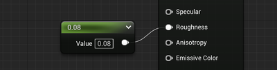

The easiest way would be to already set the correct value in CGA, this would create all material instances with the correct value.
Otherwise a slightly faster approach directly in Unreal would be to open the Parent Material, delete the connection to the roughness value in the material and connect a constant value node with the desired value.
Another approach would be to use Editor Utility Widgets https://docs.unrealengine.com/5.3/en-US/scripting-the-unreal-editor-using-blueprints/ to adjust all the materials via blueprint scripting, but it would probably take some time to get started with this approach.

Hi,
The easiest way to add reflections to your scene is to decrease the roughness value on your building materials (I got similar results to the screenshot when I set them between 0.05-0.1). This can either be done in Unreal https://docs.unrealengine.com/4.27/en-US/Resources/ContentExamples/MaterialNodes/1_4/ or already in CGA https://doc.arcgis.com/en/cityengine/latest/cga/cga-material-attribute.htm
Improving the reflections can be done in multiple ways, I would suggest to look at the following website https://docs.unrealengine.com/5.3/en-US/reflections-environment-in-unreal-engine/
Best,
Benjamin

I appreciate your response on this. So if I go in to the generated mesh > then materials > I see a bunch of materials there. What I also see is a Parent Material (opaque). I can go into each material and set the roughness value from there but that would take a lot of time, because that would take ages, is there any way I can adjust the roughness for all those materials. I'm sorry if this is a noob question.
BenjaminSteger1
CODEWYR
Thank you. It works.
