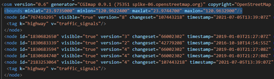

Hello,
I am currently working on a project that requires paired data of satellite images and OSM maps. The "Get Map Data" function can provide the necessary data, but the OSM maps obtained through this function lack boundary information. Without this latitude and longitude data, I cannot do the subsequent calculations.
I would like to inquire whether there is a way to obtain OSM maps with boundary information using the "Get Map Data" function, or if there are alternative tools available for acquiring paired data of satellite images and OSM maps. Thank you.

Thank you for bringing up the OSM boundary information. The OSM importer in CityEngine doesn't need this information. Could you please tell me more about the "subsequent calculations" you want to perform?

Hello, thanks for the reply.
Currently, I need to calculate the latitude and longitude coordinates of the center point of the OSM map and the size of the map for further data processing.
