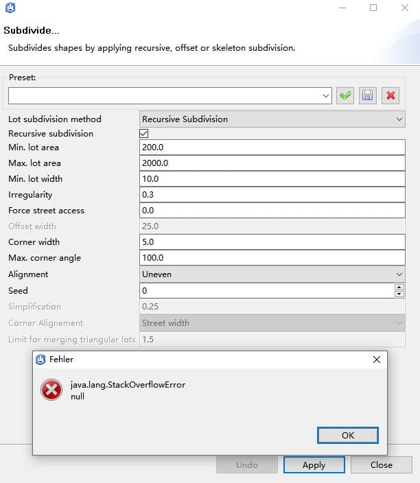

Hi, I got StackOverflowError null when using subdivide function in menu bar. I selected all of my vector polygons and want to subdivide them at the same time, then the error message appeared.
Is anyone meet this question? I even didn't know what caused this error.
Thanks a lot if you can give some suggestion!

Also, when you get such messages as shown in the screenshot there are usually more details written to the log (Window -> Log). Then right click -> export entry... and attach it here.

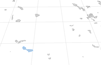

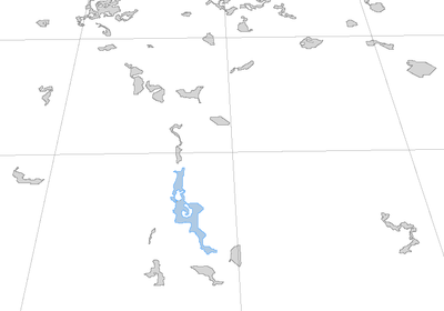

Hi Jonas! I have checked my shapes according to your questions and found that only part of them will cause this error, and they mostly look like the picture below. If the shape is more simple, errors will not happen.
Furthermore, it may help when I change the subdivision parameters sometimes(e.g. Min.lot.width, Corner width, Max.corner angle) , but more often than not it doesn't work.
Actually, I have to process more than thousand of shapes. So I hope there is a way to solve this as efficiently as possible.
