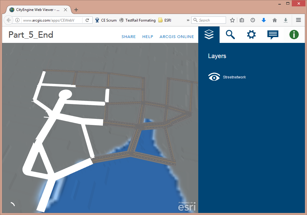

I'm having trouble exporting all of the selected objects in the viewport to City Engine web scene.  I've included screen shots of the steps I took to export the models showing the process steps.  Any help as to why the streets didn't export would be appreciated.  Thanks.

Hello Jim,
thank you for providing such a detailed report.
Normally the street network shows up white, like other shapes, that have no rule attached.
No quite sure, why this does not happen in your case. But anyway I suggest to add the esri.lib rule file Street_Modern_Simple.cga to your streets.
