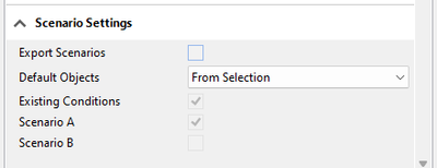

Stefan_Harding
  • I'm exporting city engine model to unreal engine and i want to export scenarios, but the options for scenario in the export setup don't work
  • The resulting datasmith file
  • The scenario options

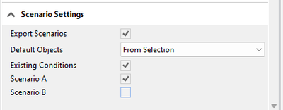

JonasObertuefer
What version of CE/Unreal are you working with?
In general: If you select a scenario to export the selection has no effect on it. All objects of a selected scenario are exported
The different scenarios should be available for selection/deselection as soon as the you check the general "Export Scenarios" option
If this is not a case this might be a bug.
To further investigate (if you still have the described issues) we would need you to share the CE project with us.
Best
Jonas
Stefan_Harding
I used 2023.0 for some earlier tests that gave corrupted datasmith exports, for the newer one I updated to 2023.1 and the scenario options that you show here grey out after one export and continue to be unselectable. Her is a download to one of the project's with greyed out scenario options:
https://drive.google.com/drive/folders/1xNTR8zi04j029-pr4wC2KGlwPE4VWyOk?usp=sharing
I have gotten a brand new project to work without issues, but i have no idea why.
JonasObertuefer
thanks for providing the project. It could reproduce it on my side, it seems there is an issue with the scene file itself. When I created a new scene file and imported everything from existing one, I can again use the scenario settings.
We will investigate this further but this might take some time, in the meantime I hope you can make use of the workaround described above.
