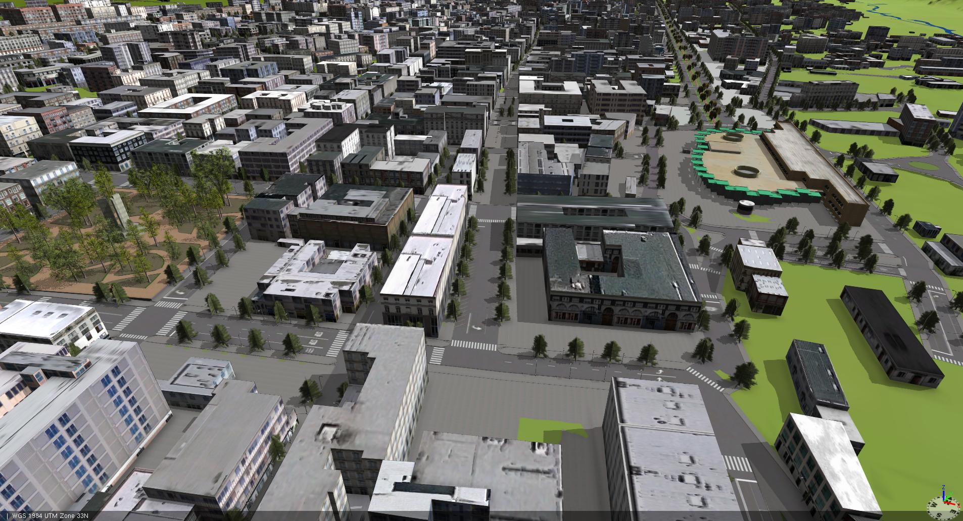

I'm creating a 3d city model with real gis data. I created 3d buildings using "building from footprint" rule, but when I chose a specific texture all the facades of the building are mapped with the same image. Is it possible to change the texture to each facade? Any idea?
Here is an image of the my scene created with CityEngine 2015.2. As you can see, each building has the same textures, but in the reality they are different.

Hey Valerio,
The textures on the walls look different from one another. Can you clarify which textures you are choosing and replacing? Are you trying to match textures to specific buildings?
There are other foot print rules to try for sure, but what is the goal I guess?

Hi David,
Thanks for your quick answer. I want to apply a different texture file to each surface on the building. As you can see in this image, this building has 2 different facades, and I want to be able to change the texture to each facade

I see! So for the same building you want to change the texture by face. So the reason why most foot print rules don't immediately do this is because they are likely to not know how they are oriented (what is the first edge? how long is it? etc). For example, some of the buildings in scene have multiple small edges that  each have to be textured separately. It might be possible to use the comp operation to create different texture choices by face orientation, but to get results that are oriented by the street you will need to check the first edge settings and how you work within them.
Others might have more advice. Do you need to have complete matching detail for your scene?
