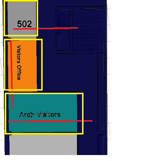

Hi,
I would like to use a Rule to create a text from attributes that would be embedded into a room polygon, and base on its length (horizontal or vertical) (See the attachment) also wit would be good to scale text base on the polygon size
This example I use one Rule per Room - that's why its different orientation/ size
And here is the Rule I have been using,
Can you help me modify this Rule, so I can use only one Rule for all my floors ( and get all the room names - scaled and placed horizontal/vertical- based on it room area?)
Thank you!
Lukasz

You would need to import the 3D text rule into your room rule, then try different ways of scaling a start shape for the text rule, probably deriving it from the floor of the room. There are numerous attributes to control the text size and whatnot, and you would want to set those based on the length of the string to display (use len() CGA function for that). I haven't used the rule in a while, so I don't know it off the top of my head.
Note: The rule uses OBJ models for each letter, and are very heavy in poly count. (might slow down your scene)
Chris

Hi Chris
Can you help me modify the Rule, so the labels are horizontal and in the center of each room?
I think it is your Rule (3d text)
