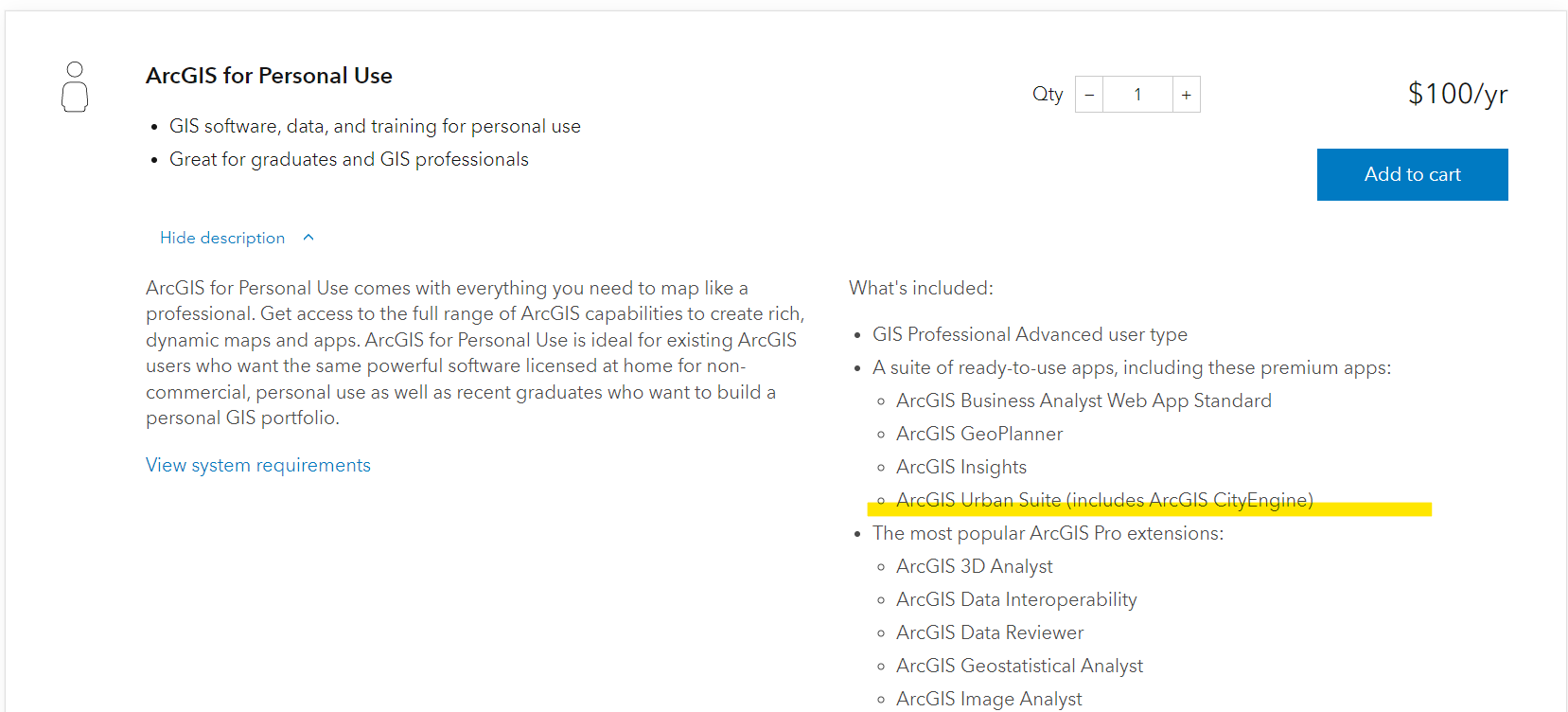

Hi Talents,
I have subscribed "ArcGIS for personal Use", so I assumed CityEngine is also included in the service.[attach0]

Since I already officially subscribed "ArcGIS for Personal Use", instead of trial,  it seems I can use full version of CityEngine[attach4].
Which means, I paid the subscription fee but cannot use because of authorization issue.😂
