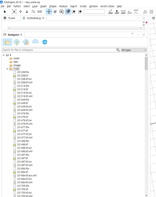

I want to batch import and export batches of multiple heightmaps (.tif) using cityengine python API. Has anyone encountered this problem? I'd appreciate it if anyone could point me to how to do this.

Created scrapbook for fbx batch export of all terrain in 3D view. But it doesn't work. What's the problem?
Created on 2022. 4. 29.
@author: user
from scripting import *
# get a CityEngine instance
ce = CE()
ce = CE()
if __name__ == '__main__':
layers = ce.getObjectsFrom(ce.scene(), ce.isLayer)
for layer in layers:
objects = ce.getObjectsFrom(layer, ce.isShape)
ems = FBXExportModelSettings()
ems.setOutputPath(ce.toFSPath(r"filepath"))
#set other options
ce.setSelection(objects)
ce.export(objects, ems)
pass
JonasObertuefer
hi again,
First, you should clean up your script:
  • 2x ce = CE()
  • 2x if __name__ == '__main__':
Then you need also to define how you want to  export terrains in your FBXExportModelSettings() e.g. if you want to export all:
ems.setTerrainLayers(ems.TERRAIN_ALL)
