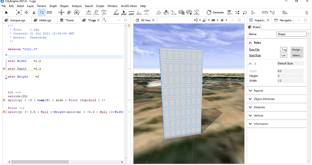

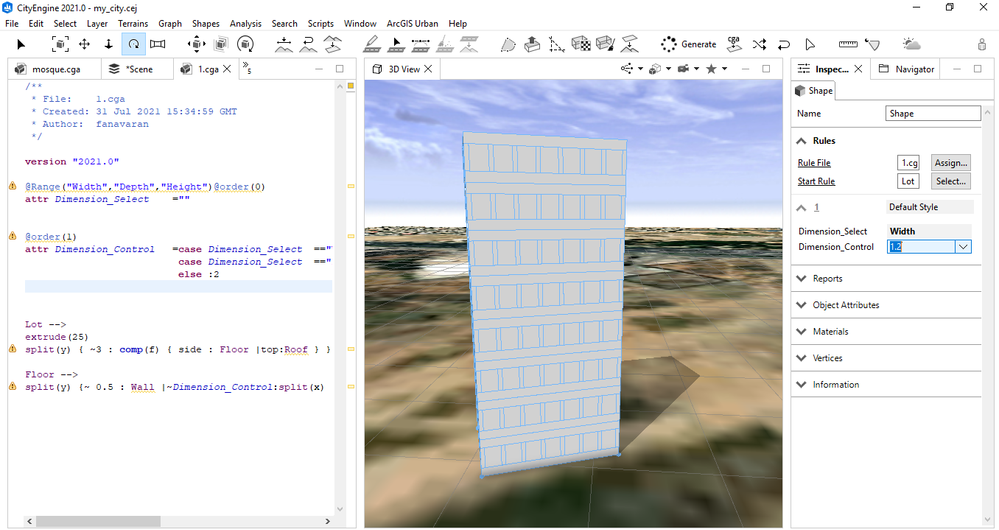

Hadi_yousefi
hi  CherylLau  . very thanks for your answer . very good . Is this method applicable to numeric attributes as well? For example, a numeric attribute to control three other attributes, such as building window width, window length, and window depth.That is, when we select the window width option in the building window attribute, we control the window width through a numeric attribute, and then select the window height option and change the window height value without changing the window width and depth numbers.
CherylLau
Sorry, I don't understand what you mean.
It is possible to have separate attributes for window width, height, and depth, and changing one of them will not affect the others.
attr window_width = 1
attr window_height = 2
attr window_depth = 0.5
But, I don't think this answers your question.  I don't understand what attributes you want and what behavior you want (i.e. what you want to appear in the drop down box for each attribute).
Hadi_yousefi
Hello dear CheryILau . very thanks for your answer. In order to be able to control the dimensions of width, depth, height separately through the dimension_control attribute, so that by changing the dimensions of each option in dimension_control attribute, the value of other options in dimension_control attribute does not change .Instead of using three attributes of width, depth and height in inspector separately, use only one attribute to control them.Is this possible? If this method can be done, the inspector will no longer be crowded due to too many attributes5664.png
by Anonymous User
Not applicable
If your goal is to manage the attribute space, consider using the @Group and @Order function to make it more visual intuitive.   You can also create a new code and call that it into an existing code and that code will have an "accordion" drop-down, which can be a strategy to save space.  If your trying to have one attribute control width, depth, height, your going to overwrite the other two attributes each time.  You could use a table for this but it would be more complicated than its worth, in my opinion.
