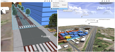

It would be good to have more control for organisation and management of bookmarks (views) as the title of the post suggests. We have currently over 50 bookmarks in a current project that covers multiple sites over a large geographic extent. It would be good to have the ability to group and have subgroups of bookmarks similar to the scene navigator; and additional for the save snapshot button to be separate so you don't have to scroll all the way down in order to export the view.

Bookmarks are tied directly to camera views rather than being scene objects, which is why they can't be grouped in Layers.
That said, a way to structure bookmarks is to add multiple cameras to your scene – this lets you effectively group your bookmarks by camera. Hope that helps!
