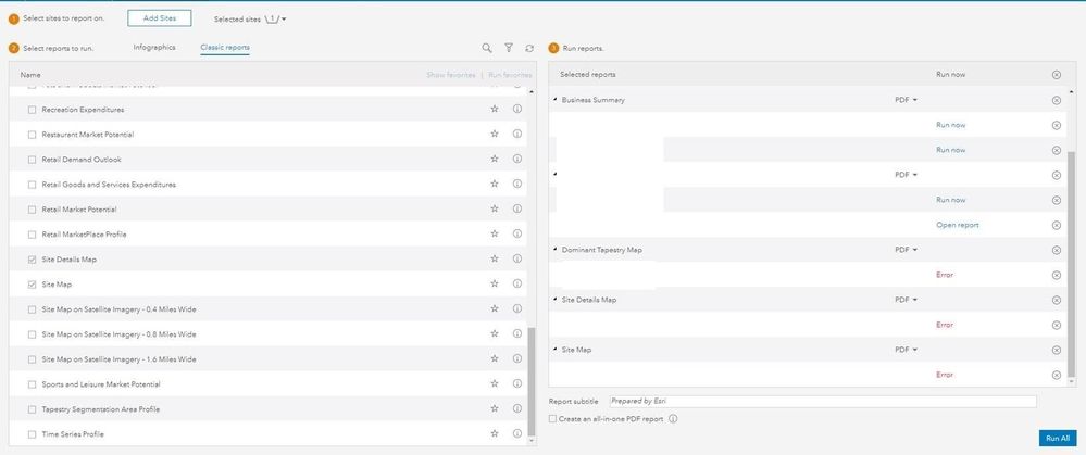

Also having this issue in Business Analyst Enterprise (10.9).  Unable to print reports or infographics that contain a map.
Error when printing Map based reportsError when printing Map based reports
Tags (2)
DanielStauning
Hi @KevenSuzuki1 Sorry for the late reply, can you try installing this patch to the GeoEnrichment server? It addresses issues with running map reports in BA Enterprise 10.9. https://support.esri.com/en/download/7911
