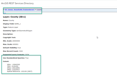

This is what is usually expected for a layer when working with custom data:

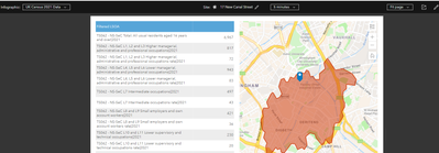

And when that parameter is define, the infographic returns the expected custom data variables:
I looked at other Living Atlas layers in USA for example and they all show the extent and spatial reference defined.
