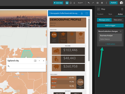

The key functionality you are requesting is already available in ExB. You just need to enable action trigger on the map and configure the BA widget as follows:
Then, whenever you select a feature from the map, the attributes of that feature will be shown in the custom infographics. Please note that the custom infographics must be created in BA web app first by using the web map layer attributes. You can learn more about this here: https://community.esri.com/t5/arcgis-business-analyst-blog/best-practices-when-sharing-and-running/b...

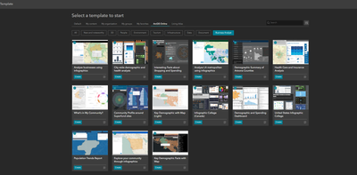

I encourage you to explore the several ExB samples we published under + Create new > ArcGIS Online > Business Analyst

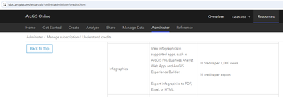

thank you for your response - I did discover this function but felt that the performance was unnecessarily slow since the attributes are so readily available and could be improved, see attached video. Could you also let me know  if there are any credit implications in this path, that seems unclear, I would hope not since rendering a chart from user data should not incur credit usage?

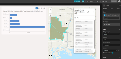

@PaulBiggWither I recommend exploring the chart widget instead as that might work better for your use case. The performance will be much better and there will be no credit usage.
When running infographics using the BA widget, the performance will be different as the process takes time to go through our geoenrichment servers. And regardless of the data source in the infographic, there will be credit consumptions as documented when running/exporting infographics:
