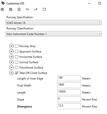

A potential workaround for making this Take-off flight path area would be to use the ArcGIS Aviation Airports  ICAO Annex 14 tool in Pro - but use a Custom JSON File to limit the output to match your needed specifications.
 You can make a Custom JSON file with CustomizeOIS.exe which gets installed with the Aviation Airports Product Files under the Utilities\CustomizeOIS folder with PDF instructions.   I suggest you try saving out a custom JSON which only creates an Annex 14 Take Off Climb Surface,  but editing the parameters like this
Length of Inner Edge= 180, Final Width= 1800 Length= 10000, Slope= 0, Divergence 12.5.
Attached is a zipped JSON that I saved out like this.  If you try it with the Pro ICAO Annex 14 OIS tool, choose Non Instrument Code Number 1.  This should give you geometry output for the custom surface, but will have attribution in the output ObstructionIdentificationSurface_MP for Annex 14 Take Off Climb Surface, so you should edit them accordingly.
