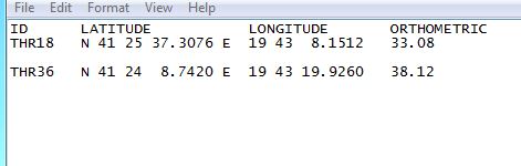

I want to make ols for annex 15,14  this are the point of threshold could tell someone how can make ?

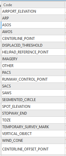

David airport control point is aerodrom referenc point
DavidWickliffe
Yes- the AirportControlPoint feature class has a field called PointType which has values for Airport Reference Point (ARP) and for Airport Elevation and many other points

Hi Altin,   To make the Annex 14 and Annex 15 you would :
  • Create and Airports 18B geodatabase- see the video :  Video Link : 6072
    • you can use a local projected coordinate system, or maybe use and AZMED projection as suggested in the video.
  • Create a line feature in the Airfield\RunwayCenterline feature class.
  • Use the ICAO Annex 14 tool - see the video:  Video Link : 6408
  • Use the ICAO Annex 15 tool.  This one will generate the Area 2A, 2B and 2C eTOD areas around the runway(s) that you input.  (data attached)
