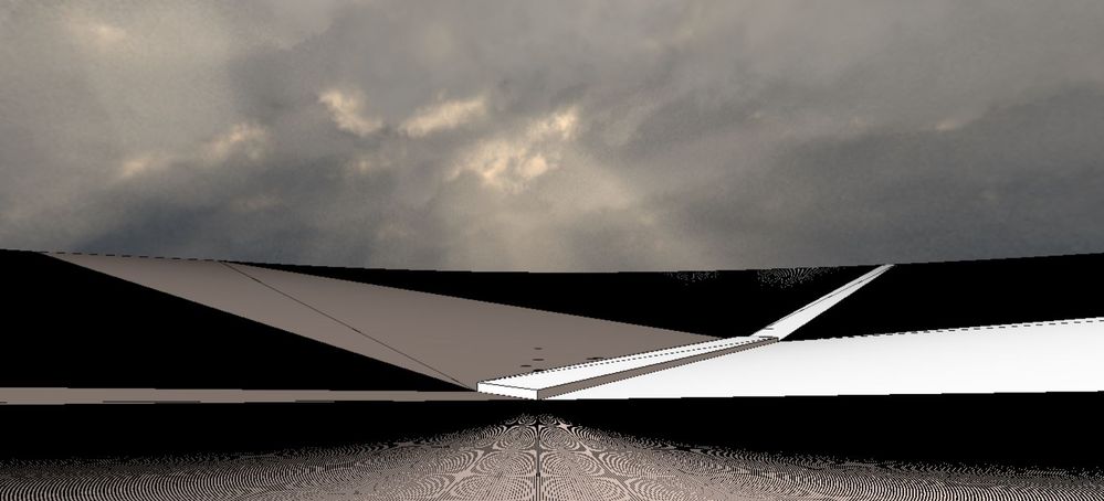

AltinPojani
Hi
I have done my  OLS 3D  about your video  but when I see the zone 2a,2b ect in local scene doesnt look in 3d the zone Can you help me to find the problem
Thnx
Altin
AltinPojani
HI
PLEASE ATTACH IMAGE FOR  MORE IF  I AM OK OR NO IN ZONE 2A,2B ECT IN 3DFIG ANNEX 15.JPGFIG ANNEX 15.JPG
Sara_Courter
It is hard to tell if the elevations are correct without the actual data. If you need more assistance, you can submit a support case and specify that you need support from the Aviation team.
