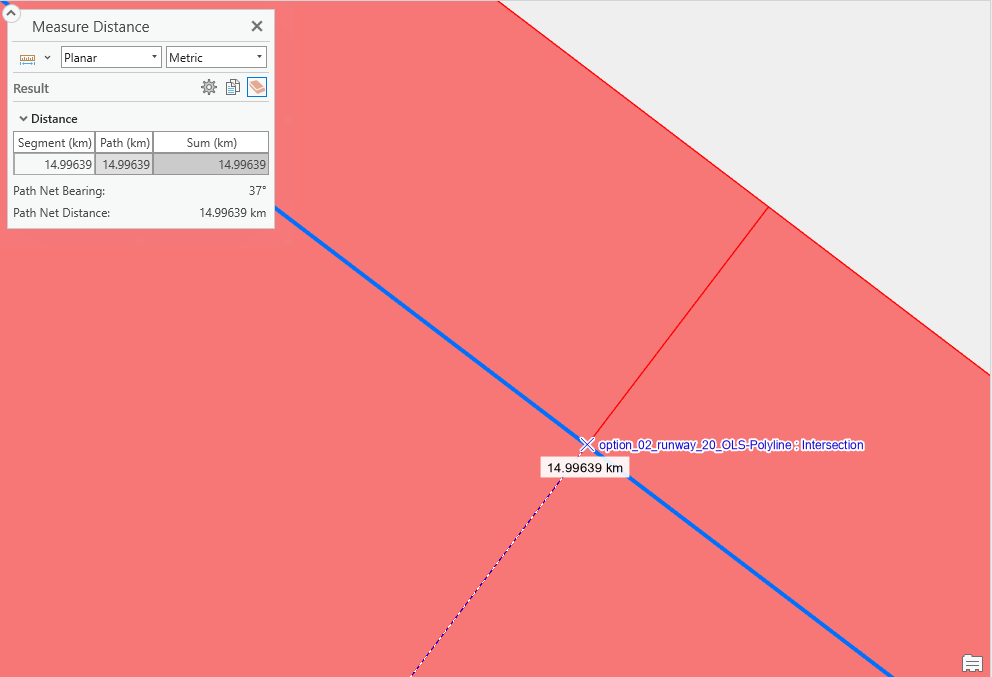

I just generated a 15km long approach surface using the customise json tool:
and it is short by approximately 3.5 meters.
The blue line is the extent generated by the ArcGIS Airports GP tool:

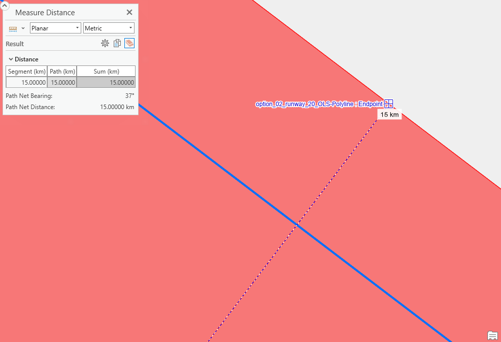

The red area is from a dwg generated using an alternative CAD based method:
All Data is projected in NZTM/NZVD2016, both in ArcGIS Pro and in the input CAD dataset.  The measurements are made in ArcGIS Pro 3.3.5 and all scenes/maps are also in the same coordinate system.
Any ideas what could be causing this difference?

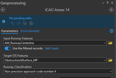

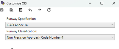

When you set up your customize OIS, what Runway Specification and Runway Classification did you use? See the example below.
And when you ran the geoprocessing tool, did you input the same Runway Classification?

We created this surface using Precision Approach Category I Code Number 3 4

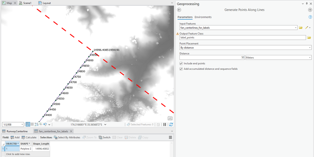

Another example:
say we want to generate labeled points showing distances from the end of the runway strip. This measures from the geometry, which uses the PCS:
In my previous response I said 3.5m over 15km isn't enough to be concerned about, but given that there are going to be a bunch of little issues that potentially arise from it, I'm starting to think otherwise.
