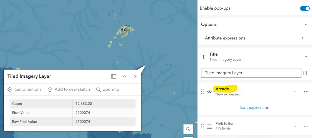

Fields List in Pop-up

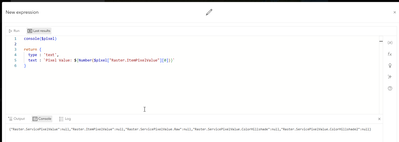

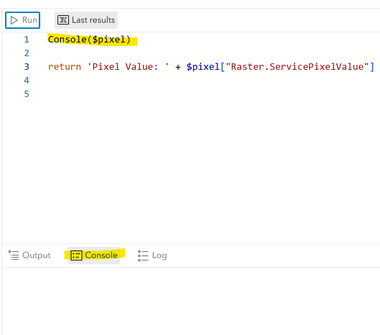

Arcade Expression: (Console shows default message, no pixel value)

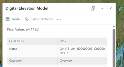

I was using this image service.
Also, when using an Arcade element, you have to return a dictionary
return {
	type : 'text',
	text : `Pixel Value: ${Number($pixel["Raster.ItemPixelValue"][0])}`

This code works in my popup. I get an error in the console when running it, because everything in $pixel is null in the test environment, but it does have values in the popup
mdesh23

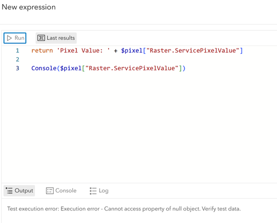

Interesting, I am getting an execution error in the test environment, with nothing showing for Console($pixel). Even I just go ahead and add the arcade expression, nothing shows in the pop-up. Even the text that says "Pixel Value: " does not show, I think because of this execution error.

However, in my test environment it still shows an execution error and the Console does not populate with anything which I don't understand. It seems like this maybe be an issue with tiled imagery layers?

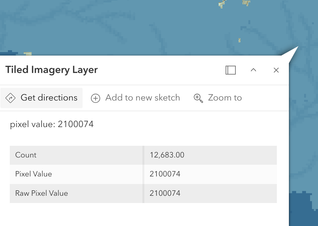

The actual pop up displays this now:

In my experience, the text environment uses the first item, whether its a feature or pixel. I'm guessing the first "pixel" is null but all the others will return a valid response. I would also get the execution error when running it there. However, as shown in the image, I do see what the keys are in the $pixel dictionary.
The reason I was using "Raster.ItemPixelValue" was that it's shaded relief image. The "Raster.ServicePixelValue" key returned an array like ["69","176","45"], representing the red, green, and blue values.
