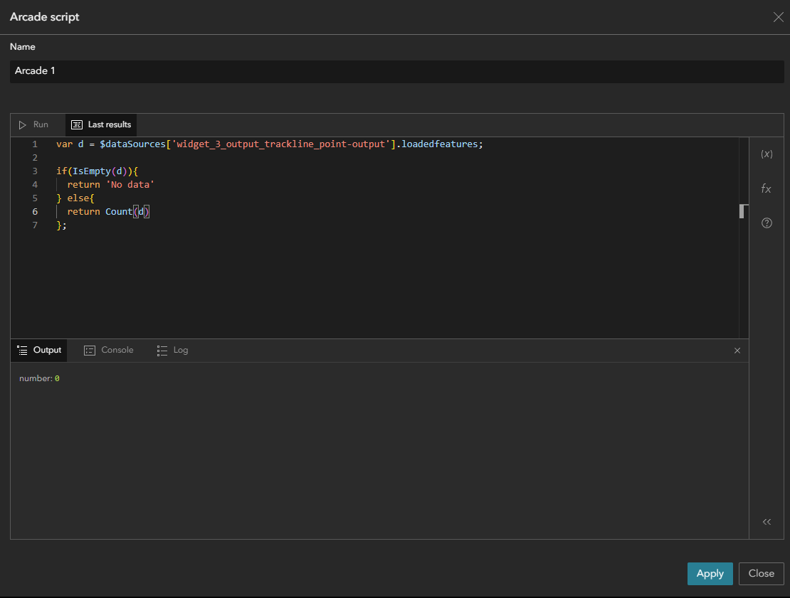

ClintonBradley
@HaydenWelch Thank you so much for the reply.
I think my issue is becoming apparent as this isn't working either. Everything returns 0 or NaN. I should have mentioned previously that I've tried looping through the feature sets previously with a counter and the counter always returns 0. The datasource is the output of the My Location widget and in the Text widget, I've only selected the path output when connecting it to data (but I just tried including both path output and locations output with no change). I assume I'm referencing the output properly. 'widget_3_output_trackline-output' (see code below) came from returning $datasources in the arcade editor.
This is the code I'm running now. I tried connecting to the selected features of the output as well and changing the code to use the selectfeatures property but same result. I will continue to research/experiment but if you have any other ideas, let me know.

ClintonBradley
I can see you going down the same path I did haha. Sorry for not explaining that either. Yes, so the only profile variable available is $datasources and in the absence of any documentation or code snippets (that I can find), the only thing I could do was just start drilling down into what's exposed through $datasources and hope to find the info I need. But that's my issue. Although I can drill down, it seems that no info is ever returned. So it seems to me like the objects themselves are never actually being accessed. The layer property looked promising to me too, along with loadedfeatures and selectedfeatures. I will try .layer again and see if I can get anywhere. And then there's queryparams as well...
One thing that occurred to me over the weekend is I think I can enable manual path tracing (which I assume means I can draw paths on the screen) so I shouldn't have to republish my app and then walk down the hall to collect data to test with haha.
Thanks again for your help. I'll let you know if I figure anything out.
ClintonBradley
I just connected the My Location widget to a table widget and all of the attribute info appears there. So I'm thinking I must not be properly loading the datasource. That would maybe also explain why OBJECTID is the only field listed.
